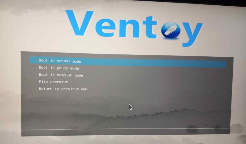

I just did this and followed the same procedure as always. Select the second option “install with NVIDIA DRIVER”, and press enter.
But I get a red error, which if I remember correctly says something like:
######## INIT NOT FOUND ##########
All EOS ISOs have always worked fine for me, this is the first time this has happened to me. I only use EOS on my SSD, I have never installed another operating system.
Does anyone know how I can install the latest EOS ISO without this error appearing?
I was using the same version of Ventoy for a long time without updating it and the EOS ISOs always worked correctly, so I thought it was not necessary to update Ventoy.
From now on I will update my Ventoy version of my flash drive more continuously.
Thanks again for your help friend!
Thank you very much friend, but I just read your post a little late and updating Ventoy solved the problem hours ago, so I couldn’t try “Boot in grub2 mode”, maybe it would have worked.
Anyway, this may help me in the future. What exactly does “grub2” do as opposed to “normal”?
It is a special mode that is available for Linux ISOs. It can work around certain kinds of firmware issues. I occasionally will have an ISO where normal mode does not work but grub2 mode does.
