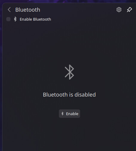

Fixed in plasma 6.0; Now it says “bluetooth is disabled” with an Enable button.
When i read the comments, look like whoever commented on this seems to have confused between: service disabled and bluetooth disabled.
The plasmoid already show when the bluetooth itself is disabled. So not sure why he said that its fixed on 6.0.
I agree with you, would be nice to show that the service is disabled when its the case.
