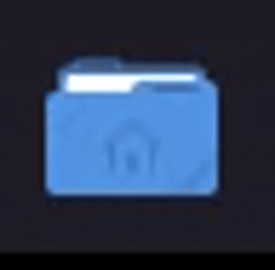

However, when starting an app with a changed icon, the selected icon will flash while the app is starting, and once started will revert to it’s default. As demonstrated in the embedded gif.

Screencast_20260429_194337
