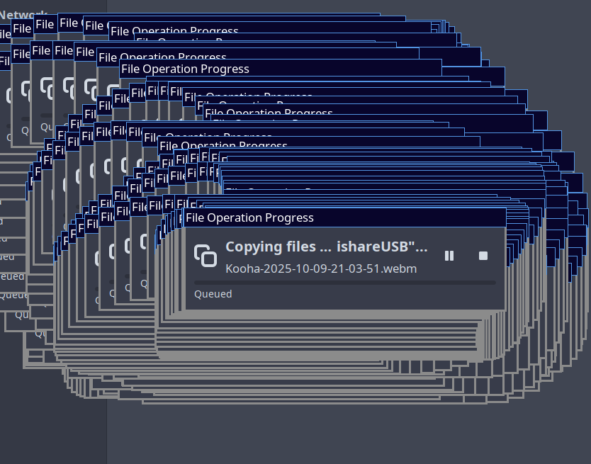

[i3] Whatever this is (Thunar)
So, Thunar struggles with copying stuff to my network drive, and when I try to drag the progress window around it does whatever this is. Can I fix it? If not, what file manager to substitute it for?

Are you using a compositor, like picom? Check with:
pacman -Q | grep -A 0 -E "picom|comp"
Looks like I don’t. Output of this command:

Okay, so to solve the visual issue, you install one.
sudo pacman -S picom
Then add picom to your i3 startup configuration file.
Wiki: https://wiki.archlinux.org/title/I3#Tearing
For the other things mentioned, please use that same wiki to search for solutions.

Thanks. This looks like working.

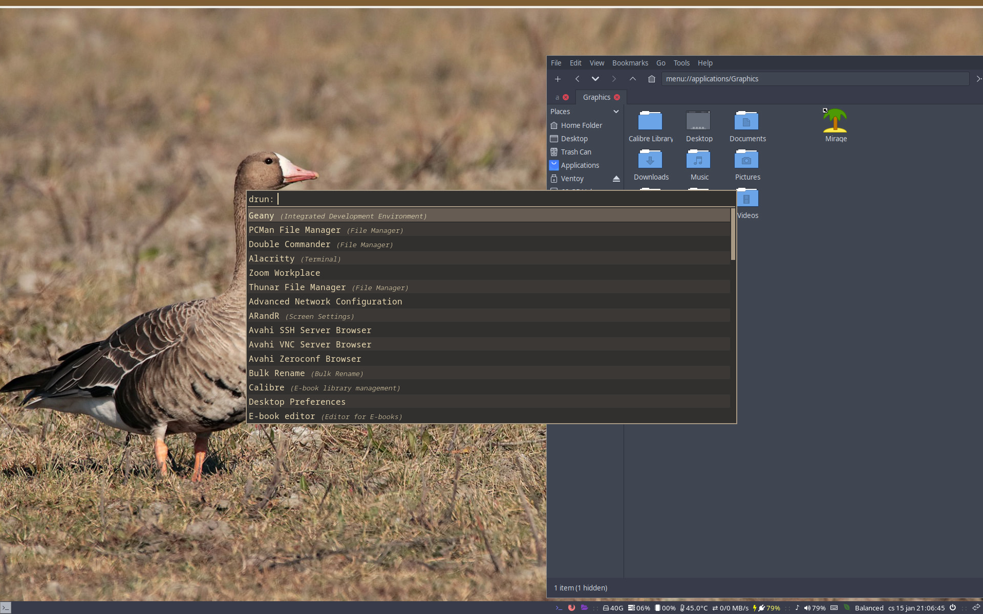

@BoredCat ,
Post festam. I wish I understood this menu question.
in config find rofi part
a simpler version
bindsym $mod+d exec --no-startup-id rofi -show drun
rofi-theme-selector
go down to gruvbox-dark-soft
ALT+A to store
Re file managers
pcmanfm-gtk3
and F3 toggles 1/2 tabs
Just some options
