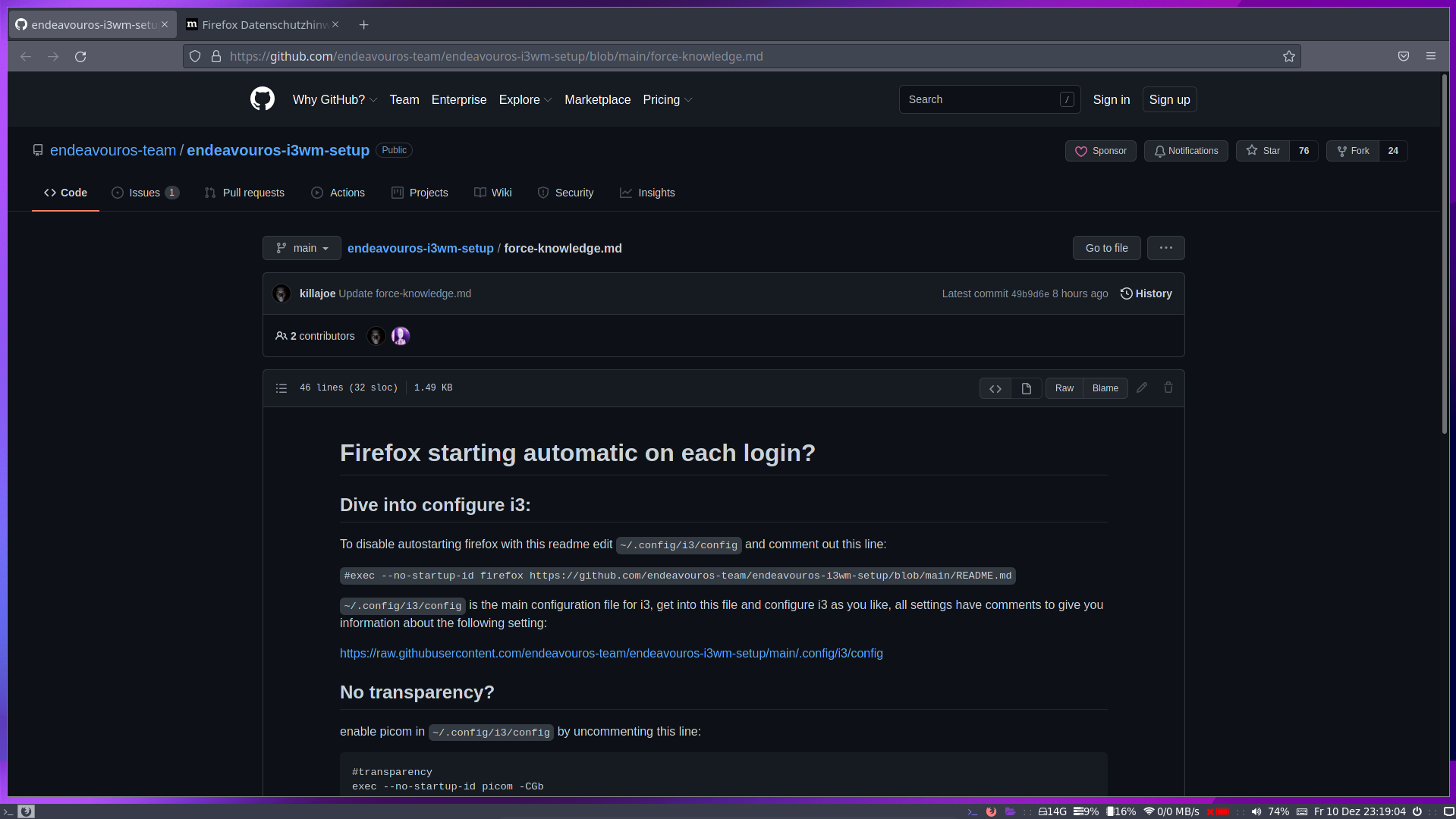

do you have theming and setup from EndeavourOS like so:
2021-12-10_23-19
Yes. As I said, the install is fresh. Firefox autostarts fine. There’s just no welcome screen autostarting, and I can’t open it manually.
