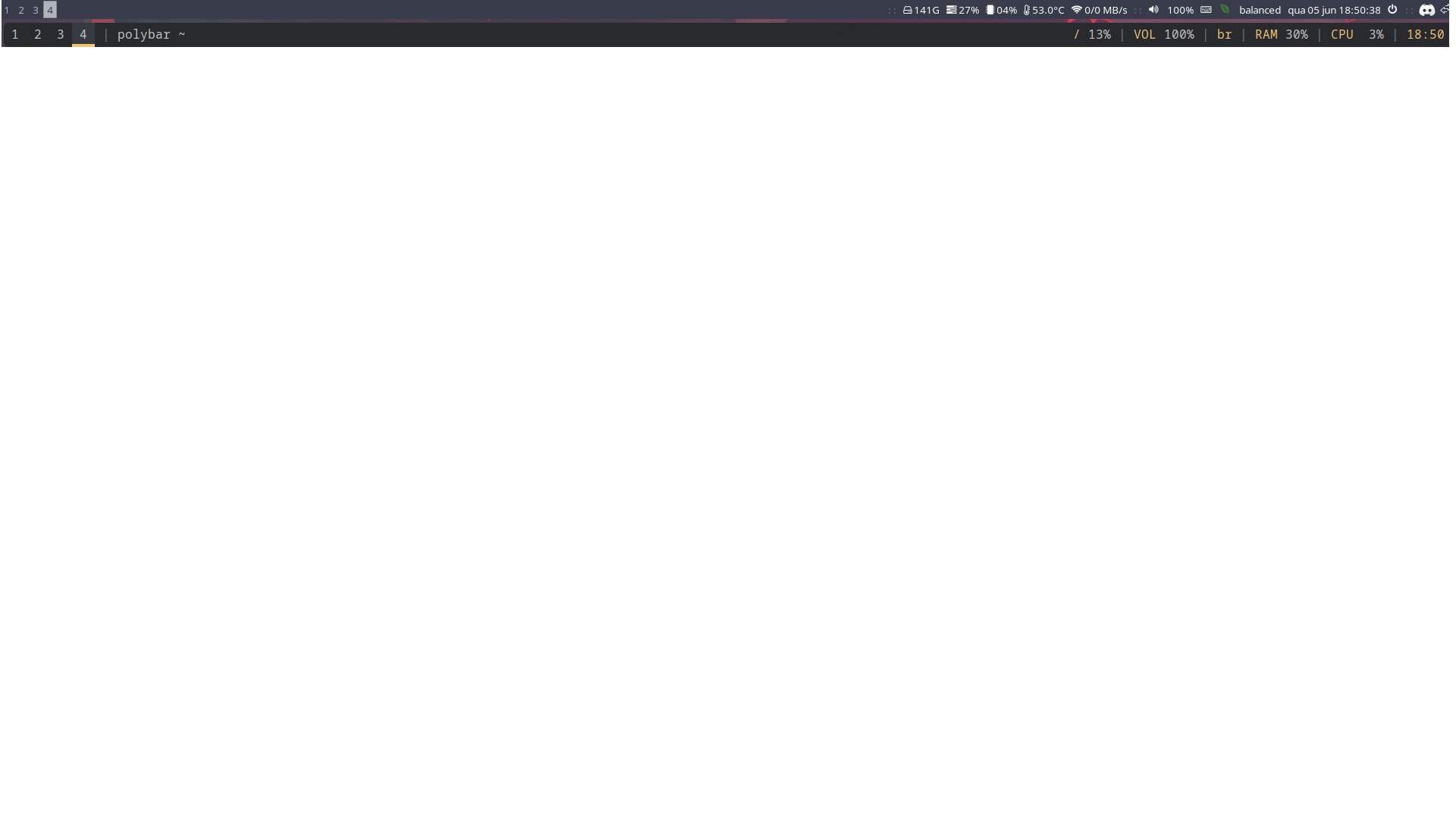

[i3] How do i make the transition to Polybar?
Fresh install of Endeavour and my first time using i3. I disabled the i3status bar in the i3 config, installed polybar and made it execute alongside i3, but it is not displaying systray icons, and if i’m not mistaken they should appear by default. What should i do to disable the i3bar completely and have systray icons in polybar ?

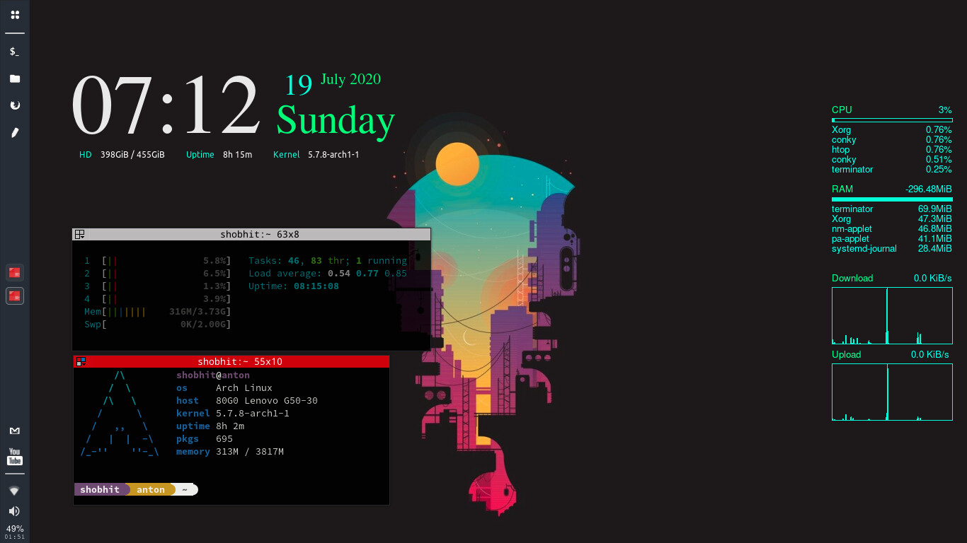

Are you sure you don’t want to use tint2 instead? It’s a bit more straight-forward/easier to configure, and you can put your systray anywhere on the bar.
OH! And you actually have clickable window buttons, if you want those.
tint2: https://archlinux.org/packages/extra/x86_64/tint2/
It can be top, bottom, left, or right.
