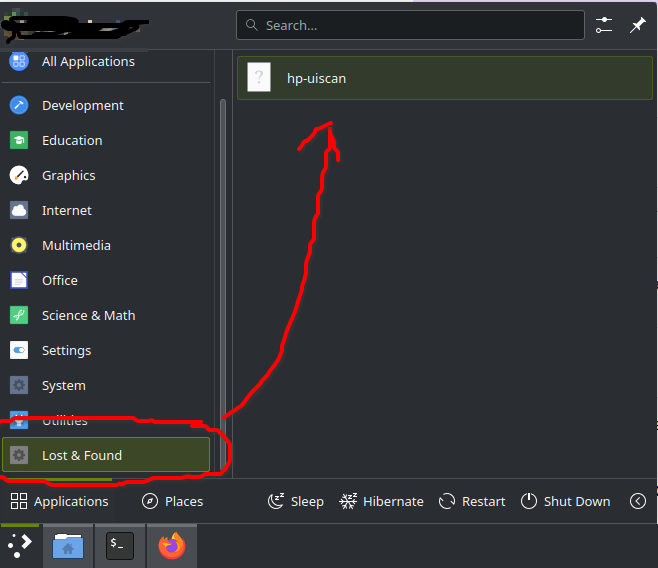

I want to delete this "lost+found"
I have this thing in the menu called lost and found, it has this file “hp-uiscan” that I remembered downloading weeks before.
I then clean reinstalled endeavourOS and I was surprised this thing exists. I tried clean reinstalling again. Oh, by clean reinstall I mean booting up from the live usb and choosing the erase all file options in the calamares install. I thought it would do the trick removing it but unfornately not.
I also tried removing files from the “lost+found” folder in case i can remove that hp-uiscan" by cd-ing to it and rm-ing but if I ls the folder, it is empty.

I see, so I get that I cannot remove the folder itself (lost+found). But is there any way I can delete the Lost & Found category as well as the hp-uiscan in it?

The OP is not talking about the “lost+found” directory on a formatted ext4 partition. The OP is talking about the Lost and Found category in the Plasma menu. If you remove the /usr/share/applications/hp-uiscan.desktop file, the launcher and the lost and found category will disappear.
sudo rm /usr/share/applications/hp-uiscan.desktop

The Lost and Found category in the Plasma menu is created for any launchers that do not specify a category in their .desktop file in the /usr/share/applications folder. If there are no launchers that KDE cannot determine the category, then the Lost and Found category will not show.
Ah I see. So far it has been the only item in that category. But I do not know why it persisted between clean installs :thinking:. So my guess now is it could also be connected to the lost+found directory.
If the package hplip is installed, then hp-uiscan will be present. Each time hplip is updated, the hp-uiscan.desktop file will probably re-appear and you will have to remove it each time hplip is updated.
That could be the reason. I indeed have the the hp printer/scanner package checked during installs. That hp-uiscan must be from it. I thinked wrongly it was the file I downloaded weeks ago. Dang.
It’s only in the lost & found category since it doesnt have a category. I could just fix that by going into its .desktop and adding one.
