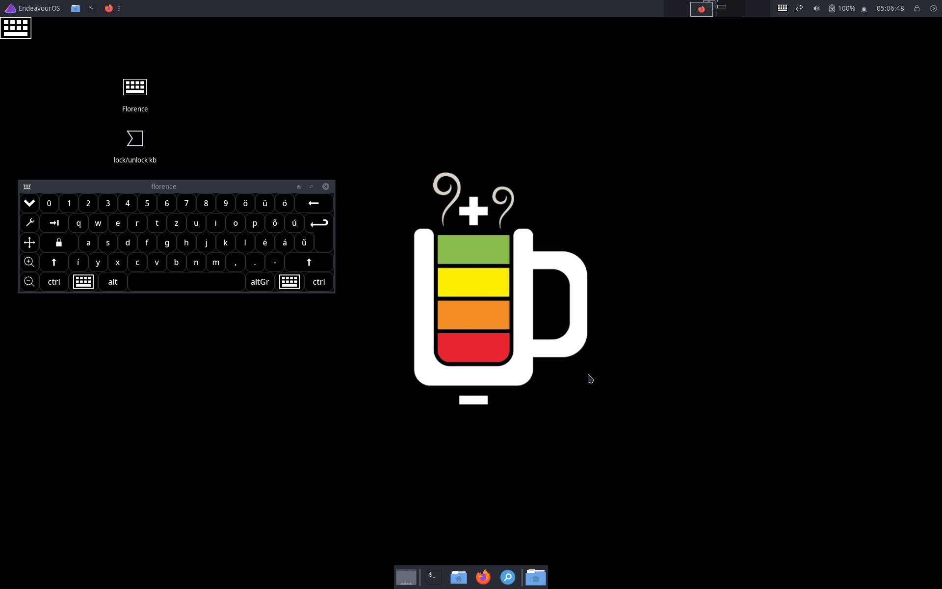

xfconf-query --channel thunar --property /misc-exec-shell-scripts-by-default --create --type bool --set true
  1. The working version of onboard keyboard (for me) is
    yay -S florence
So unless your pets can handle mouse your system is partially ‘locked’.
  1. And here comes the bonus part:
    https://github.com/adi1090x/battery-wallpaper
Thie focus was on functionality not on aesthetic appearance. Don’t shoot at me.

Then on login screen having set up Accesibilty option F3 brings up On Screen Keyboard (florence).
