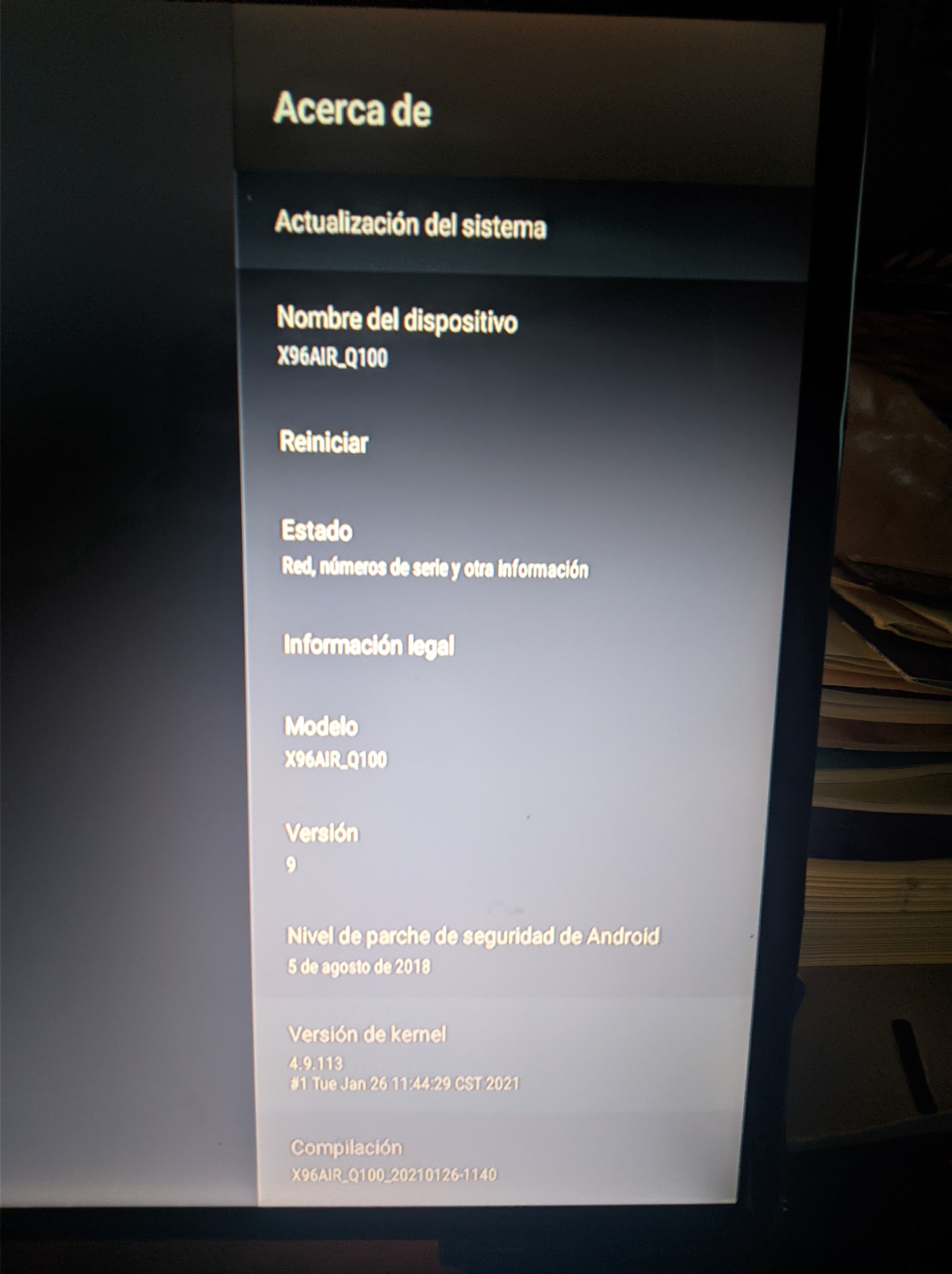

I request help to port EOS in TVBOX X96 Air (model Q100) Amlogic S905X3 4Gb/32Gb
Hello, I am trying to run eOS on my TVBox X96 air model Q100 with Amlogic S905X3 processor/4gb RAM/32Gb, because I like eOS more than Manjaro, the latter starts and works fine with the files meson-sm1-sei610LE.dtb and the extlinux.conf file with the following information:

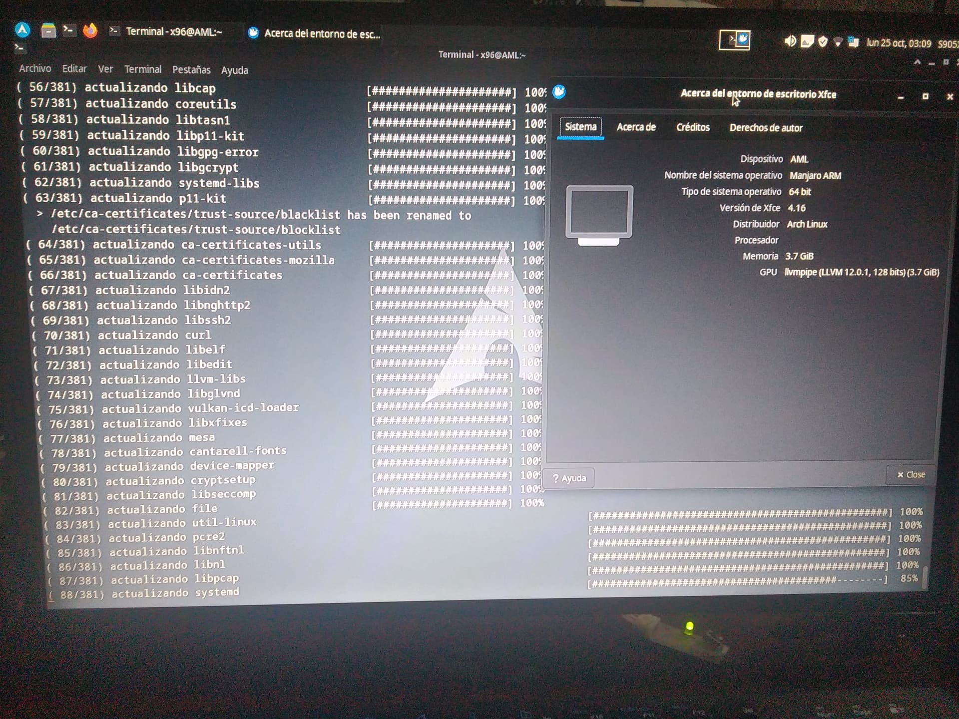

It’s correct, the way the Manjaro team works is very different, they use extlinux.conf, excuse my ignorance, but I don’t know the particular data you ask me about the bootloader, but I know that with the file meson-sm1-sei610LE.dtb it starts my tvbox in manjaro correctly and with the boot.ini file containing the following:

The first time I started my device was with the following file flashed in the usb “Manjaro-ARM-xfce-vim3-21.03.img” which is intended for Khadas VIM3 devices which is something similar to the board of my tv box, on the arch linux arm page there is no official documentation to install it on my device, it is only for popular devices.

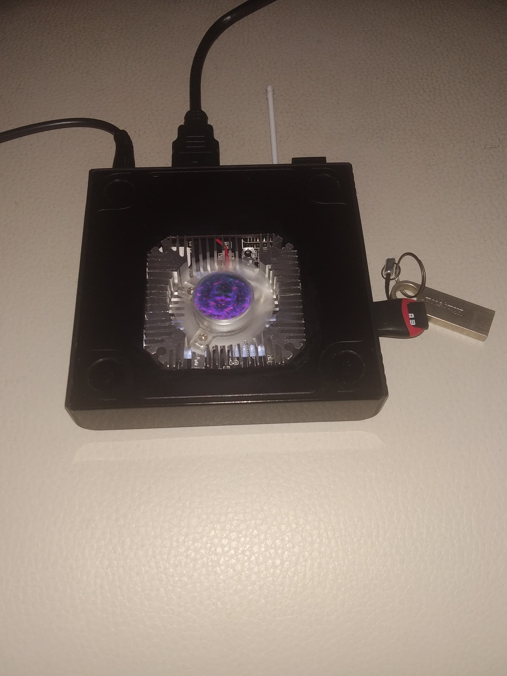

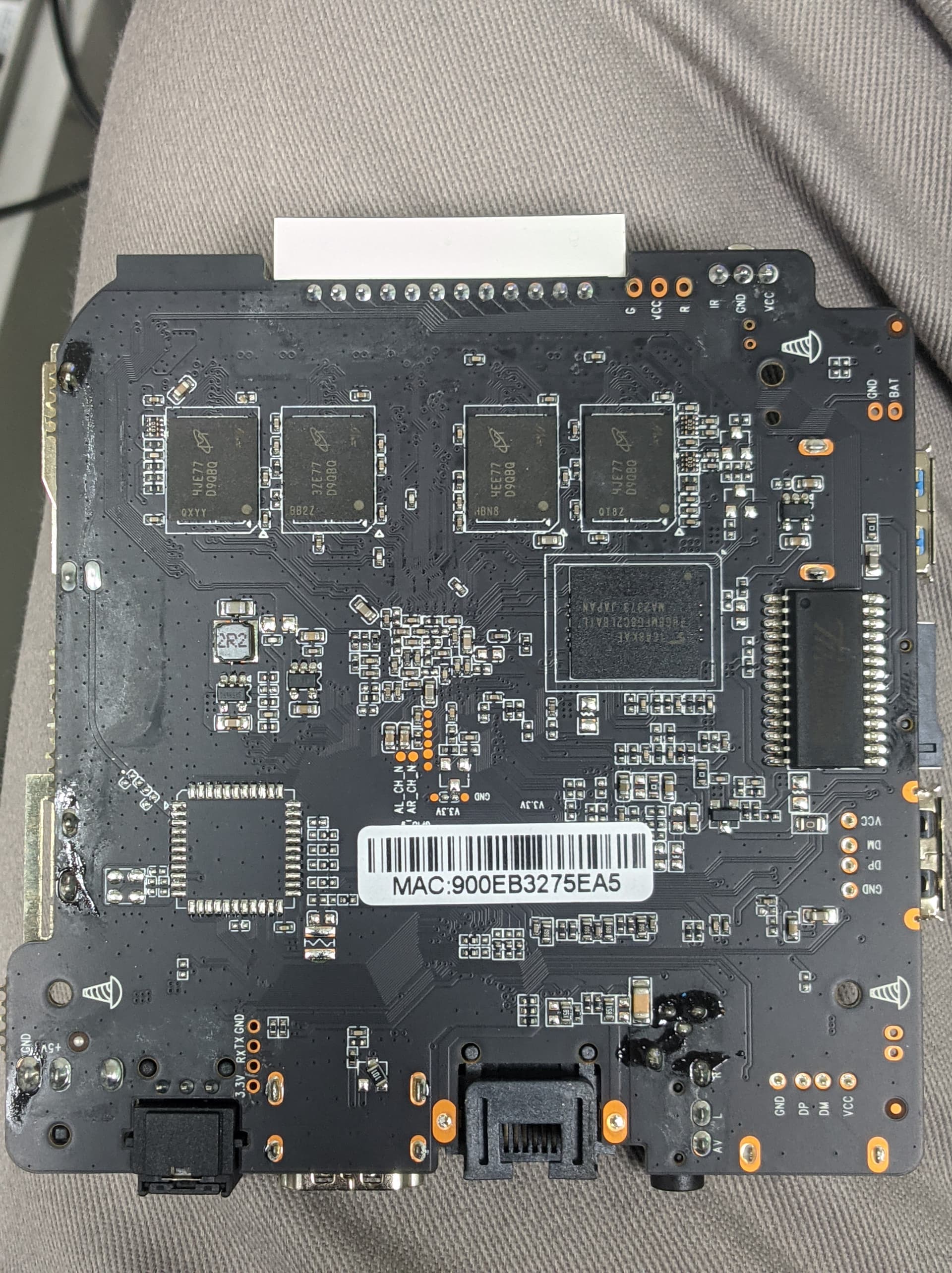

I am attaching some photos for you to know how my device is and the modification I made to it to improve temperatures, I bought it on aliexpress last year with the sole purpose of working on arch linux, at the moment menjaro is my only option, but I I wish it was EOS because it’s the one I normally use at home and work.
