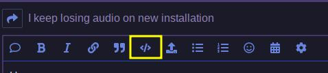

Hi.
Please click the edit button of your original post, select the terminal output, then press CTRL+E or click the button highlighted below.
Edit button:
I think I did what you wanted
