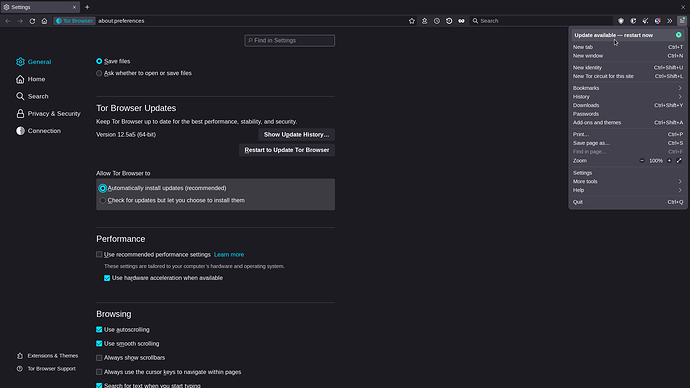

For the record, you do get automatic updates when running TOR browser as “portable app” as described in my previous post:
