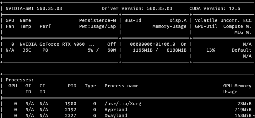

nvidia-smi output:

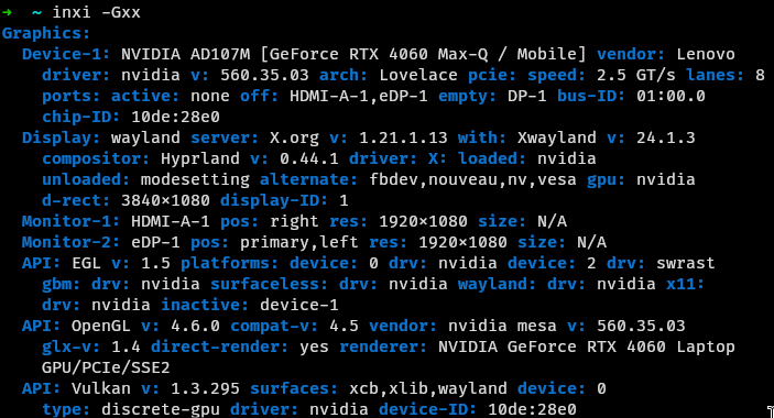

inxi -Gxx:
(Not really sure why X/Xwayland is being used here or if it is relevant).
