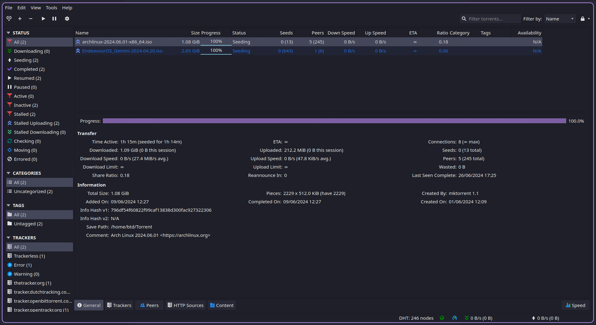

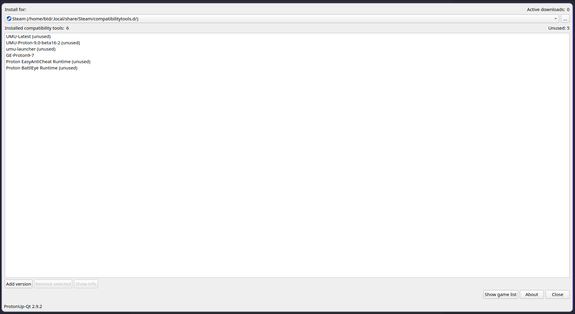

Here is an example of this problem:
And here is what a qt app should look like:
The latter (QBittorrent) applys the theme as intended but the first app (protonup-qt) doesnt.

Protonup used Qt6. That’s why it’s not working.
You will need to install a Qt6-compatible theme and theme manager, like qt6ct and/or kvantum.
It is strange that it doesn’t work though, since qBittorrent also uses Qt6. Is your installation of Protonup a flatpak or from the AUR? If it’s the flatpak version, try the one from the AUR or build it from source instead. The AppImage should also work just fine.
