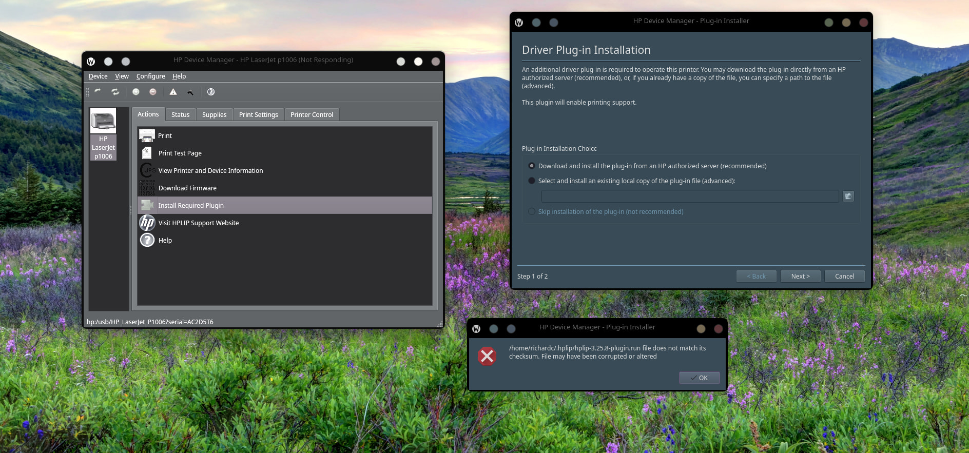

Downloading plug-in: [\ ] 0%
error: /home/richardc/.hplip/hplip-3.25.8-plugin.run file does not match its checksum. File may have been corrupted or altered
[richardc@richard-minipcpn50 ~]$
Now what?
Rich :wink:
