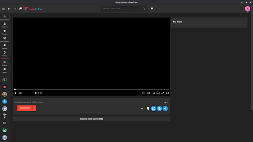

I can use some instances of Invidious in the browser but I seem not to be able to do it in Freetube.
I tried the following settings:
  • Preffered API Backend: Invidious API
  • Current Invidious Instance: https://inv.nadeko.net
  • Proxy Videos Through Invidious: ON
Freetube can get my subscriptions but I cannot play any videos:
The Invidious link for the video in the browser works.
There are two likely issues.
One is that the very few remaining invidious instances are extremely unreliable(Since they are constantly getting blocked by Youtube).
The other is that I don’t think many, if any, remaining instances work with the “Proxy Videos Through Invidious” setting.
I gave up on it. I started having Freetube proxy my videos through Tor instead. It has it’s own challenges but, for me, it is less frustrating then going through Invidious.
