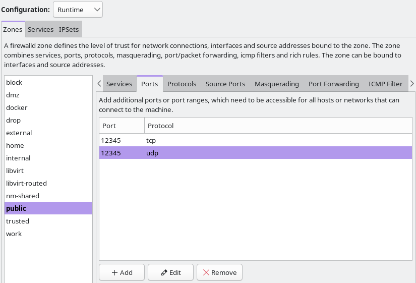

I set up quickserver and it works locally, I unlock ports via firewall-config - I select ‘Public - Ports’ and add udp and tcp 10000. The port is also forwarded on router.

By default we are using firewalld. If you are still running that you can easily open the ports that way.
Just add a service in the GUI with the ports you want open and then check the box for that service in your zone.

What GUI are you talking about, maybe I am missing something?
Here is a screeenshot of what I’ve tried:

I would start by temporarily stopping firewalld to find out if it is the problem or if it is something else.
If it is firewalld, then we can troubleshoot that further.
I have tried systemctl stop firewalld but still no access.
That means the issue is probably not related to the firewall or blocked ports on the local machine.
