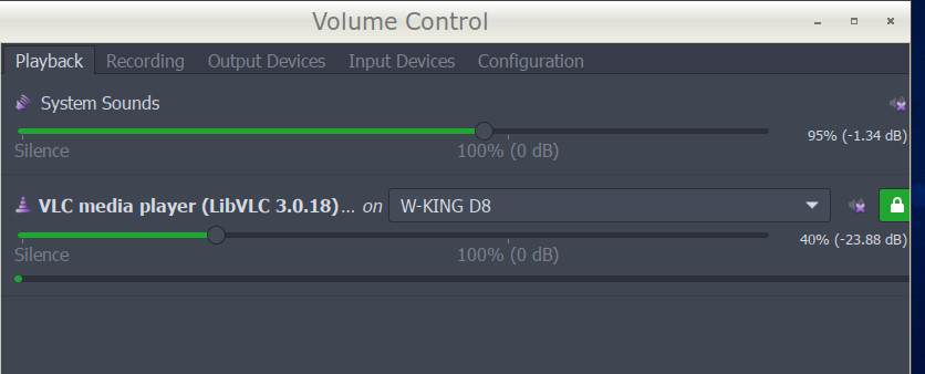

You should stay on the Server-2 which seems to be the active one. you can go into pulse and choose which device the sound comes from.
click the down arrow and you should be able to choose the device from here.

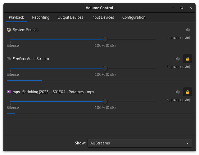

Thanks for reply. I don t seem to have a drop down like you do. Do I need to run the volume control under sudo?
click the combo box next to Show at the bottom and choose applications instead of streams see if that helps
I think Applications is part of All Streams. I get no down arrow either way.
