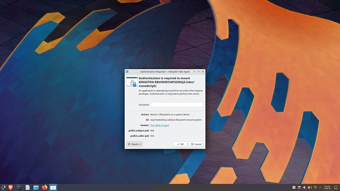

The problem is that after booting, as soon as the desktop appears, udisks is triggering the partition I don’t want to be mounted and I get a password prompt:
How can I avoid this?

The action that triggers the late mounting is coming from the DE (KDE setting, or applet) for “Auto mount disks”. This is also assumed from the password question, which seems to try to mount to standard user mount points, usually in /run/user/ . (although it should not do that, because of fstab line, but… who knows?.. :person_shrugging: Maybe the /dev/disk/by-uuid is to blame…)
OP should find this setting and modify it to not auto mount.
To verify fstab line is working as intended, try mounting in terminal, without specifying a mount point, or try with a different FM than Dolphin.

OK, I think I found it:
Screenshot_20220615_162002
Seems to work since I changed this setting :slightly_smiling_face:
edit: I will mark the post from @petsam as solution 'cause it pointed in the right direction.
