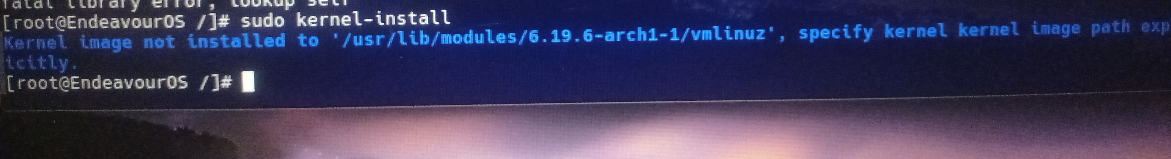

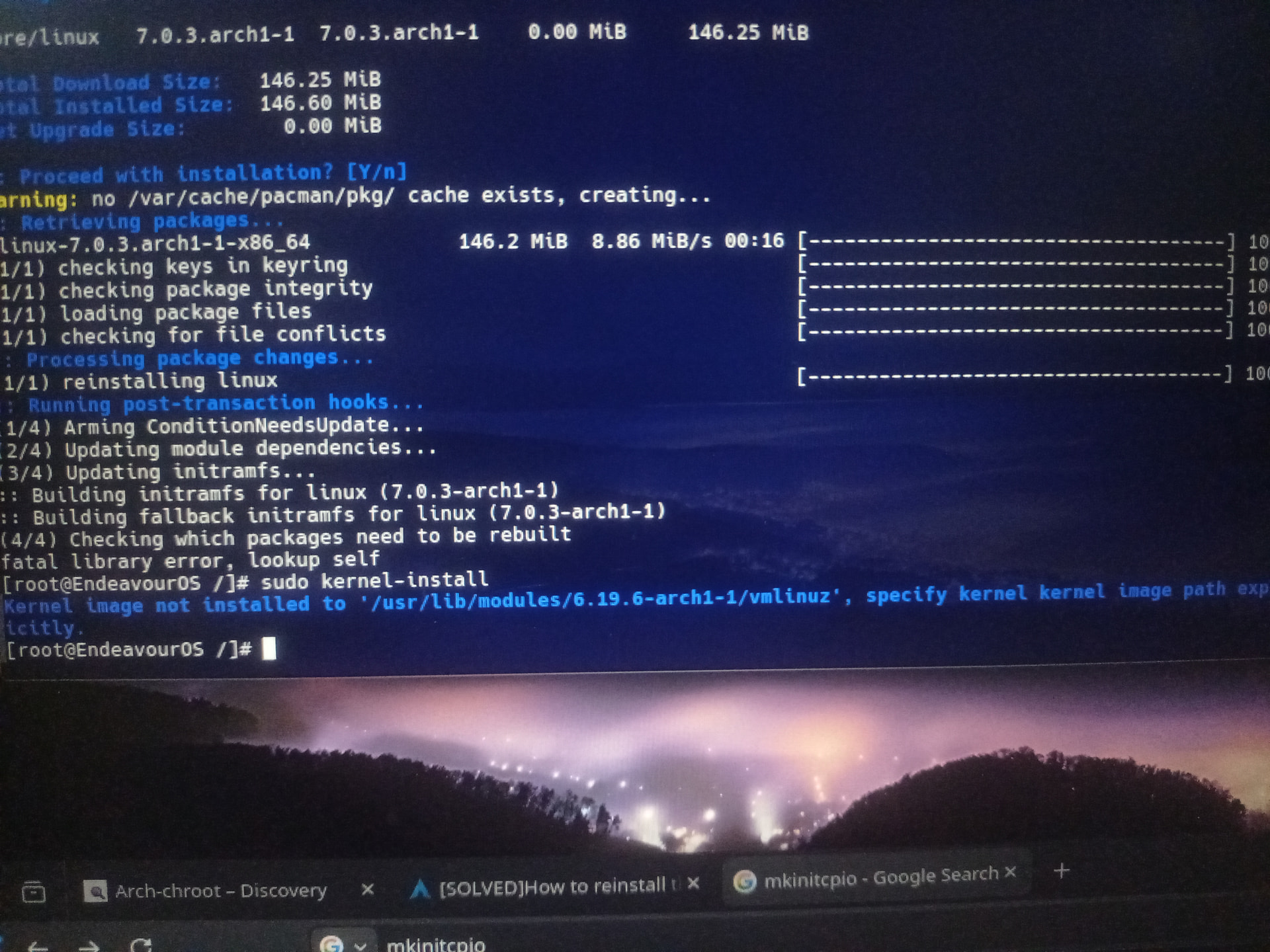

Thank you both for your answers! I have been able to chroot into my system. Also, I use GRUB so I mounted nvme0n1p1 in /mnt/boot/efi.
Do I specify this path in the image?
I also tried sudo pacman -S linux which gives me fatal library error, lookup self
