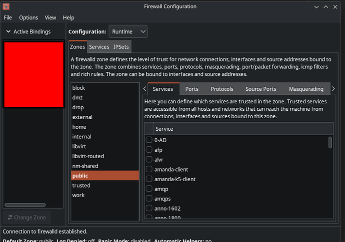

I opened the ports via the “Firewall Configuration” GUI. I also checked the nfs and rpc-bind service in runtime and permanent. Rebooted the Laptop
The result, no change with showmount -e. If I switch to trusted, everything works as expected.
