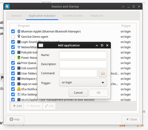

In xfce startup settings you can add a script that plays your sound. You can choose when this event will be triggerd (on shutdown or logout etc) just click on trigger
I’m not sure how this works but it implies that the sound would be played before logout or shutdown is suppose
I’ve already done that. It just doesn’t play entire melody before shutting down or rebooting. You can just hear a few first notes of the tune and the computer is already off.
