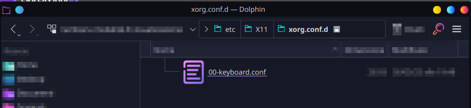

To give an example, I have a Lenovo Thinkbook 16 Gen 6, 16GB of RAM, Intel Core i5 1335u and no dedicated GPU, so I was looking at the dedicated EndeavourOS page for Intel Graphics cards. In the “Tips and tricks” section, they suggest to modify the /etc/X11/xorg.conf.d/20-intel.conf file: I have the folder, but I don’t have the file. What should I do? Shall I create the file and paste inside the suggested script? Or maybe, it’s not my case and I have missed something, so it’s better not to do this operation?

Normally you create the file in these circumstances. Edit the file is a bit ambiguous innit?
Whenever you see a file in a directory that ends in conf.d that means it is a directory that expects “drop-ins”. These are files that override only the parts of the config you specify. These files will almost always need to be created by you.
If it is something else, then you need to do more research. It is possible the information you are getting is bad information, not suitable for your distro or requires packages you don’t have installed.
