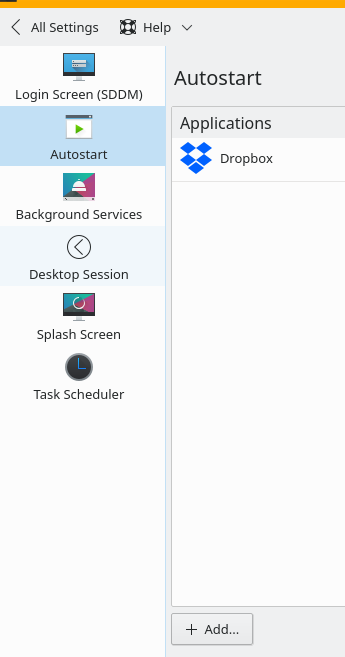

I can’t type the command in the Autostart. I can add an application, but no place for me to type the command.
autostart

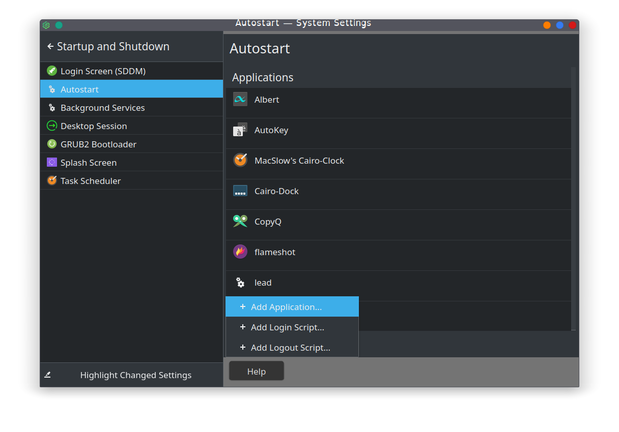

Not a KDE user myself, but this might help
That should do it!
To OP - looks like you can edit a .desktop file add in the command parameters you want (in the (Exec= line), or write a simple bash script to set it up and run it as you want. The location will be as stated in the link. Have fun!
  • Open an editor
  • Copy and paste the script from above
  • Save the script
  • Make executable chmod +x name-of-script
  • Open settings
  • “Add a login script”
  • Reboot or log out/in to test
