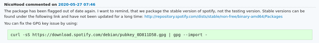

That’s the difficult part. I’m not sure how I would fix it. I only know I had key importing issues when installing Spotify, so the installation failed, and my fix was cloning the git file and building it using makepkg -si, so I assume it should work for other software as well…
also take a look at the comments on the PKGBUILD there you will mostly find a solution from other users already try to install it: https://aur.archlinux.org/packages/spotify/
