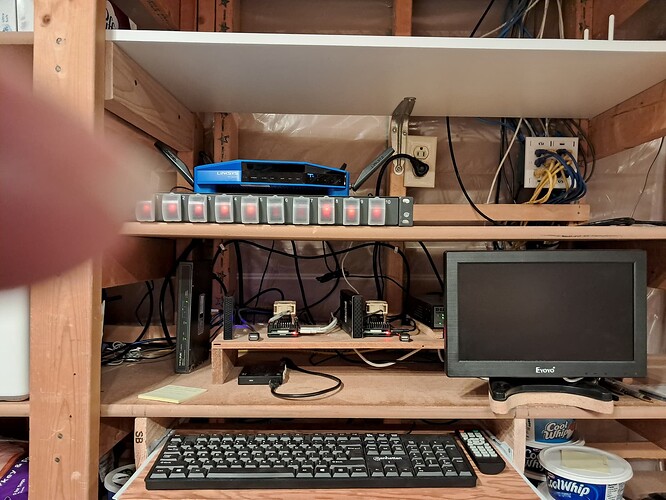

here is a pic of my Web server and LAN server set up on shelves in the Utility room.
This shows the RPi 4b 4 GB WEB server on the left, and the right RPi 4b 4 GB is my LAN server. Both run 24 x 7. To the extreme left under my stupid finger is the ISP’s cable modem which connects to the Linksys VPN router above the power strip, and ends up in a 24 port 1 GB switch behind the monitor.
