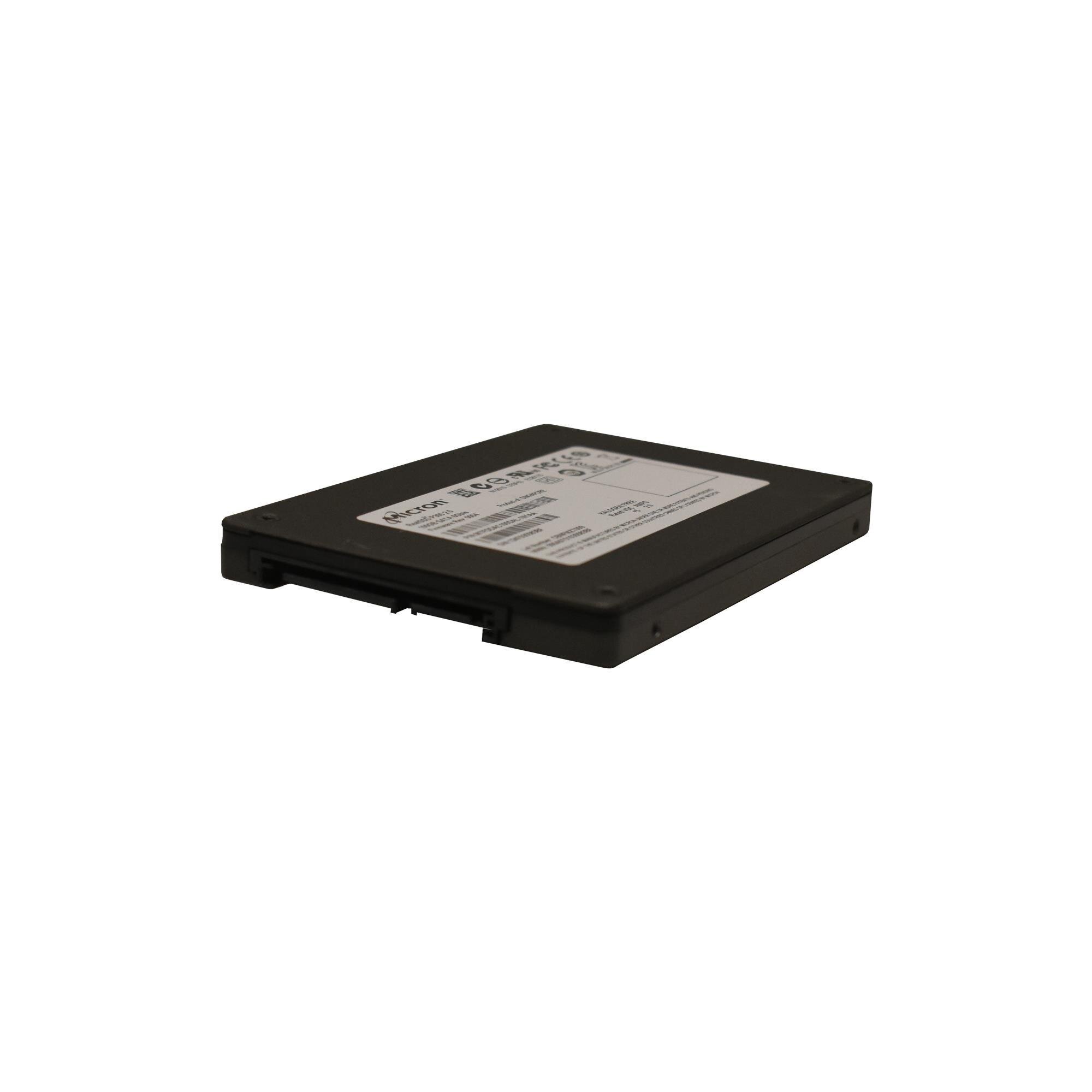

Well the only link I could find concerning a P300 is this , and that is a 50 GB ssd.
Wow, they still MAKE things of that low capacity intentionally?
Just as surprised as you are , but my guess would be that is a small laptop drive with a sort of recovery system in place for Windows (maybe).
A fraudulent disk? :sweat_smile:
Could this be 50 GB instead of 500? If you purchased a 500 GB then maybe you should take it back to where you got it and tell them that the one they gave you is only Showing 50 GB.
this makes more since with the 37 gig free space the OP reported having
Well It could be if it is bought from e.g. Ebay, but if this is a laptop it also could be a drive present , that the TS isn´t aware of for recovery or whatever. But that is hard to tell without knowing more about the type of computer (or laptop) it is.
That would be about the right size for that purpose (about all it could do).
Best way to check I guess is pull out the new bought SSD and see what it says on the label.
Op claims its new but if from somewhere like ebay then its possible the OP got a bad deal.
