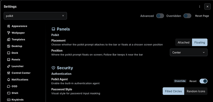

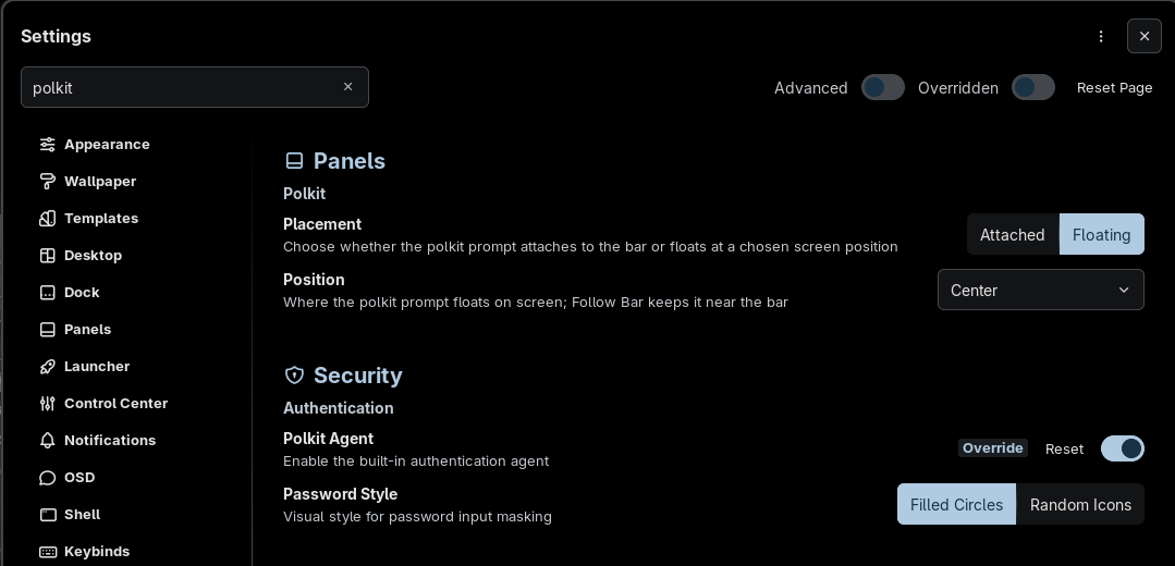

  • If you use Noctalia V5, there is a built in Polkit Agent which can be enabled under Settings ? Security > Authentication > Polkt Agent.

For additional options with Noctalia, you can use its built-in polkit plugin instead of the Hyrpland package (not tested with Niri).
I’m using Noctalia V5 as my Shell. I was going through the plugin store and I did not see one which supports polkit agents. Which one were you referring?
I did find a noctalia V4 plugin:
It’s been added as a main feature (in Settings)
Thanks for the support. Found it. I will update my technote above.
I did test Noctalia Polkit Agent on both Niri and Hyprland (worked with firewalld). I did verify that I had uninstalled the 3rd party Polkit Agents prior to testing. Its much nicer then hyprpolkitagent.
