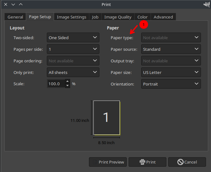

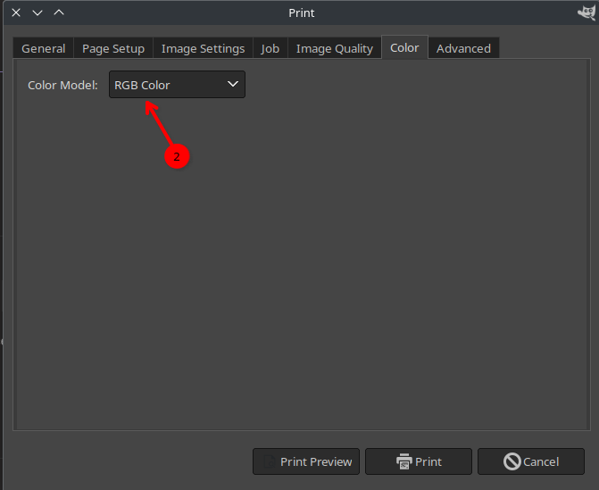

Tweaked some settings in GIMP and got the print function to work.
Share the settings?
#1. Changed Paper Type to ā€˜Roll’ from the default ā€˜Label’
#2. Color Model was empty. I selected ā€˜Monochrome’
These two changes made it suddenly print.
