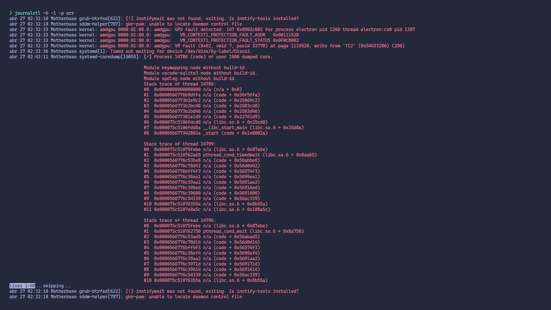

Hey guys, i noticed that there is something failing in that check that happens when you boot, reboot and turn off the system (it’s only happening on system shutdown btw). Is there a way for me to check what is going on ? Everything seems fine, but i want to investigate more to avoid future issues.
Does the error show in journalctl -b -1 -p err
There is a bunch of errors, but i don’t know if they are the same thing the is failing on shutdown, it happens to quick for me too read.
As a side note, it looks you are using grub-btrfsd without inotify-tools installed.
You should install the package inotify-tools
Ok, thanks ! i will check if that was what was causing failing next time i shutdown.
Shutdown the system yesterday and didn’t notice any errors :ok_hand:
