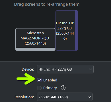

I recently got a secondary monitor. My problem is, that even when it’s turned off, I am still able to move my mouse to the secondary display or drag windows to it.
I know that I could manually enable / disable the monitor but that’s too much work to do every time:

Well I found a solution and a workaround with some help from Reddit.
1) Solution:
Use DisplayPort instead of HDMI to connect the monitor - then KDE Plasma (and also Windows) correctly recognize when the monitor is turned off and disable it.
2) Workaround:
Use kscreen-doctor to manually disable / enable the secondary monitor (and bind the command to a key)
# Disable the secondary monitor
kscreen-doctor output.HDMI-A-1.disable
#Enable the secondary monitor and fix the primary monitors positioning
kscreen-doctor output.HDMI-A-1.enable output.DP-3.position.0,1120
