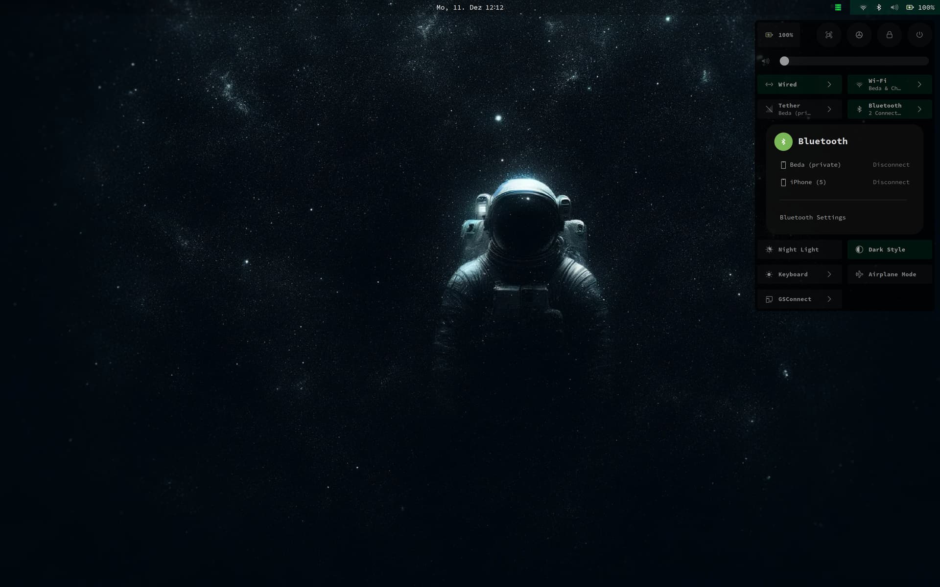

Which icon do you refer to?
The only bluetooth icon I have is in the top right menu (where you connect to devices) and right clicking on that icon does nothing.
For referece a screenshot attached

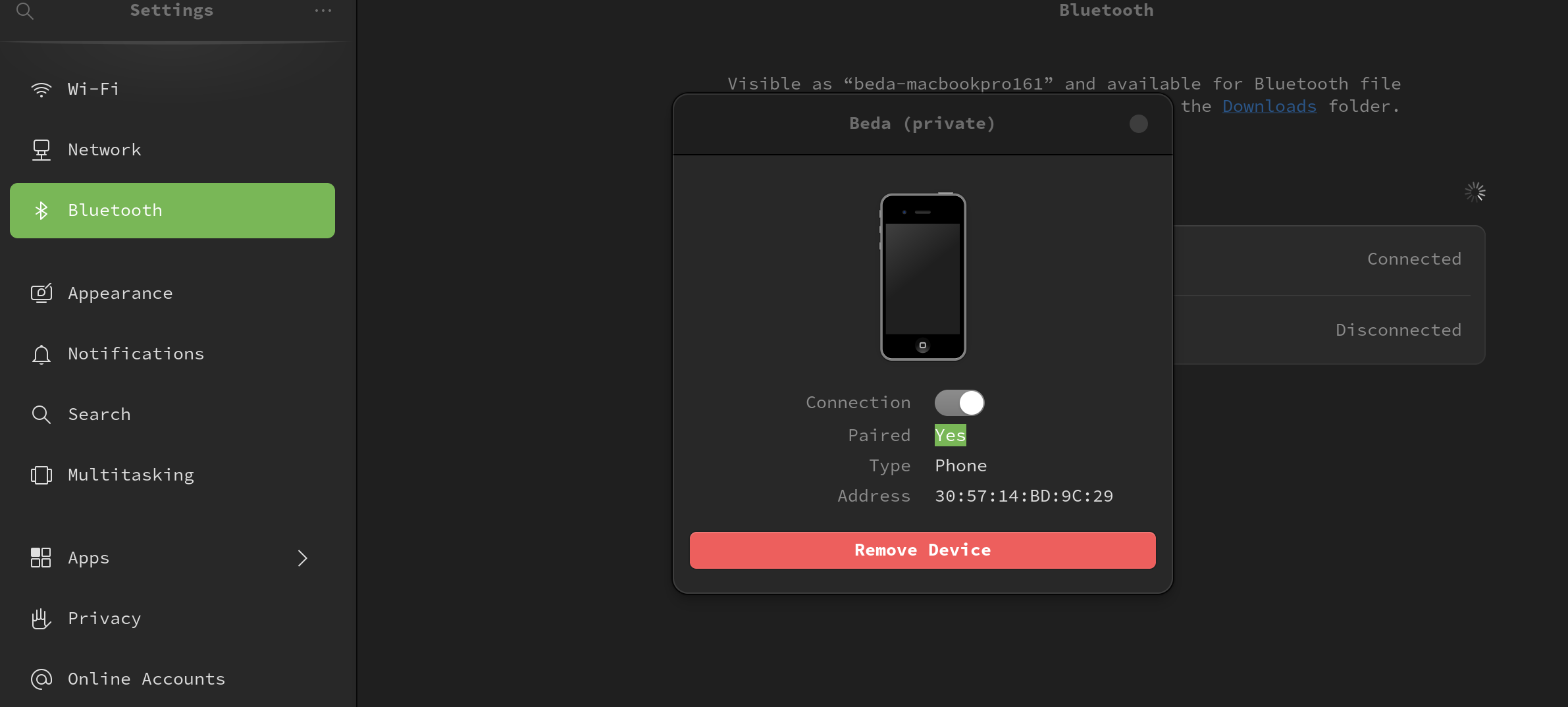

Settings >> Bluetooth >> click on the paired device that you want to send the file to >> Send Files… >> choose the file you want to send in the file picker
No luck
Are you using some specific package to enable the feature you mention?
Perhaps that is missing in my install (although I do have buez packages and also gnome-bluetooth-3.0)
BTW, yes bluetooth itself does work - just I have no file sharing options.
With “works” I mean for example audio connection.
No.
Try removing the connected device and pair it again and see if the option “Send Files …” shows up.
I tried that several times already (as well prior, during and after trying out several AUR packages that did actually add the context menu on files, yet also did not actually allow to share a thing)
I also have tried to reboot, before and after re-connecting the devices. As a matter of facts I always disable bluetooth after using it, and have to reconnect to the devices
I also tried “forgetting” the device(s), and fully re-establishing the connection, at the same result, that menu only shows bluetooth settings but no sharing options.

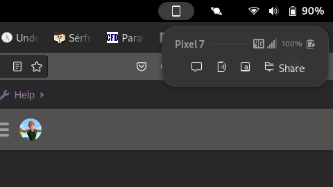

Just as an idea, if all of the devices are on the same network, you could use GSconnect (KDEconnect), which is an extension for GNOME. Makes easy to send files from computer to phone, or the other way around. Would need to set up KDEconnect on phone.
Usually after setting this up, and logging out and in (need that to have the extension appearing in extension app) I need to allow the app to connect to Wi-Fi https://userbase.kde.org/KDEConnect#I_have_two_devices_running_KDE_Connect_on_the_same_network.2C_but_they_can.27t_see_each_other
After paring, you should have icon like this (see picture), selecting share should give you drag and drop files to phone.
mynd
This is just an alternative solution. It might not work for your usecase.
Yes, I do have the connect - mainly because I wanted clipboard share
It’s a viable alternative indeed.
