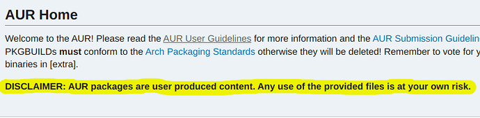

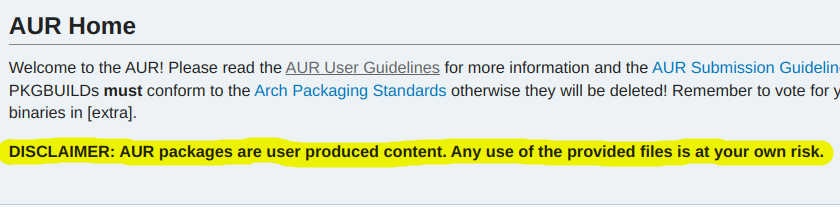

As a matter of fact, it even states on the AUR WIki the following.
If you’re afraid of yay, then you will have to download and install any software on the AUR from source, usually available on the apps corresponding github page.
Installing manually from source evading the Arch packaging system is not a recommendation I would make lightly. Especially, if the original concern was the risk of system impacting issues. Stray files that both the Arch packaging system and the user are not tracking, are likely to result in future problems.
