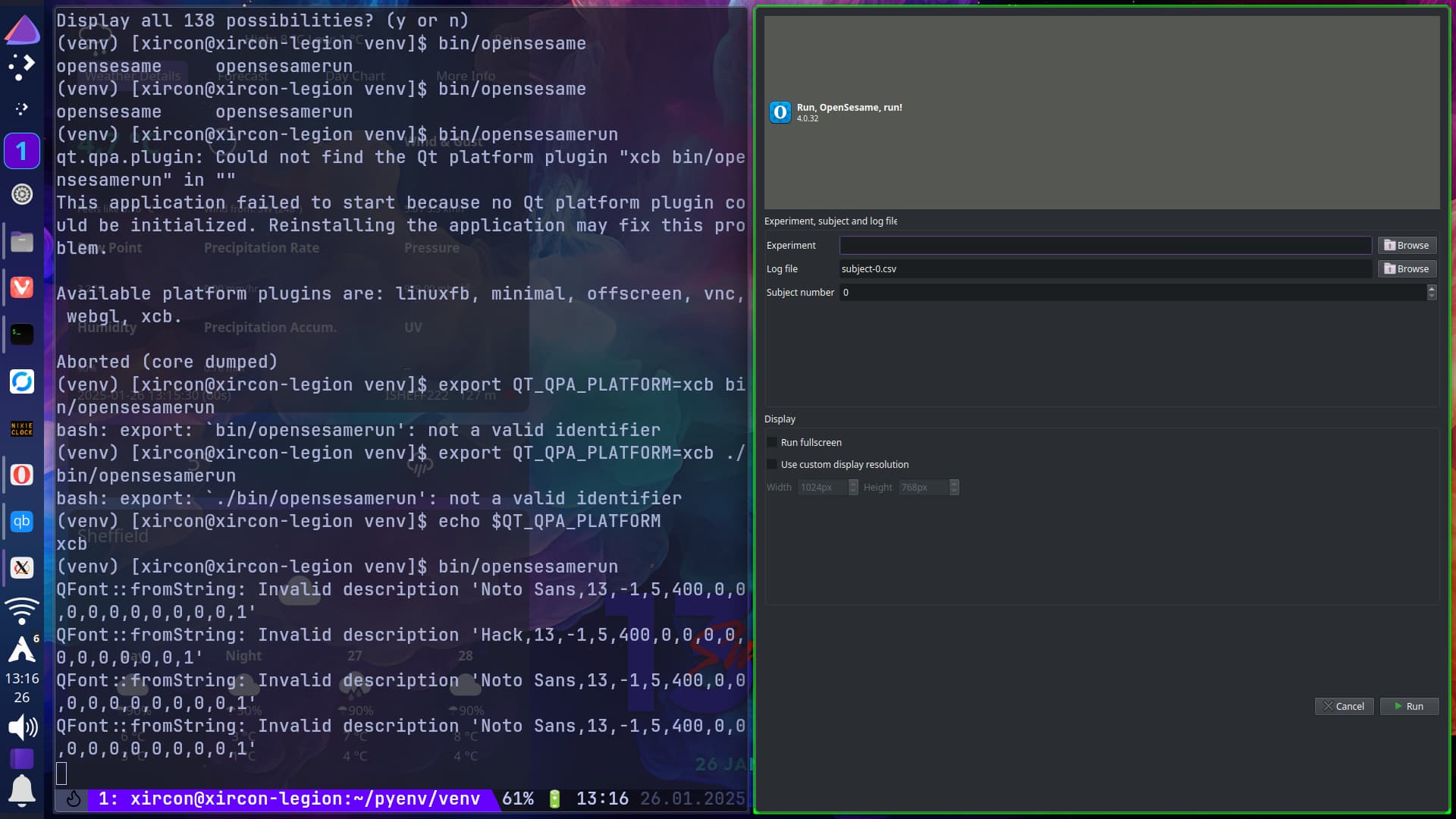

god knows how, but I seem to have it working, I need to check my command history BRB. (This was under bash, fish didn’t like it).
## Bash & Fish:
pip install opensesame-core
pip install pyqt5
## Then (Bash):
export QT_QPA_PLATFORM=xcb
bin/opensesamerun
## Fish:
set QT_QPA_PLATFORM xcb
echo $QT_QPA_PLATFORM # should say xcb
bin/opensesamerun
all the above in the venv

I have, however, got it running. It was an odd fix, but it needed a specially built version of expyriment (see what what they did there… expyriment… classic). Something about SLD versions being incompatible with two of the packages…
Anyway. All working.
