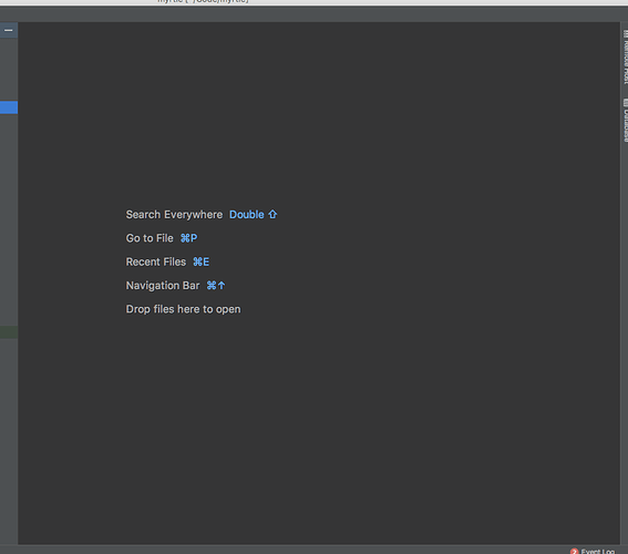

Whenever I open a New Project or File in IntelliJ IDEA or other JetBrains IDE’s I just see a gray background and nothing opens. Is there any way to fix this? I only seem to be getting this problem on Swaywm.

can you make a screenshot sort of things and start from terminal eventually it show some information?
does it shows like example :slight_smile:

This is it. It’s all I can see and I’m unable to use the program at all.
