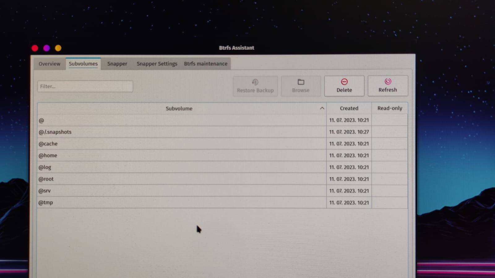

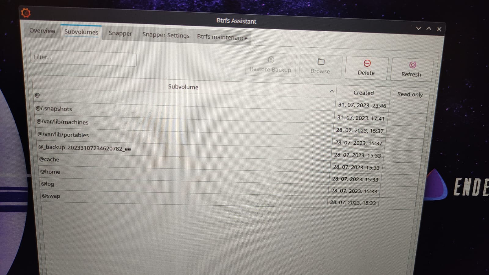

maybe something like this? sudo update-grub
my subvolumes look like this
instead of probably like this
is that relevant?
