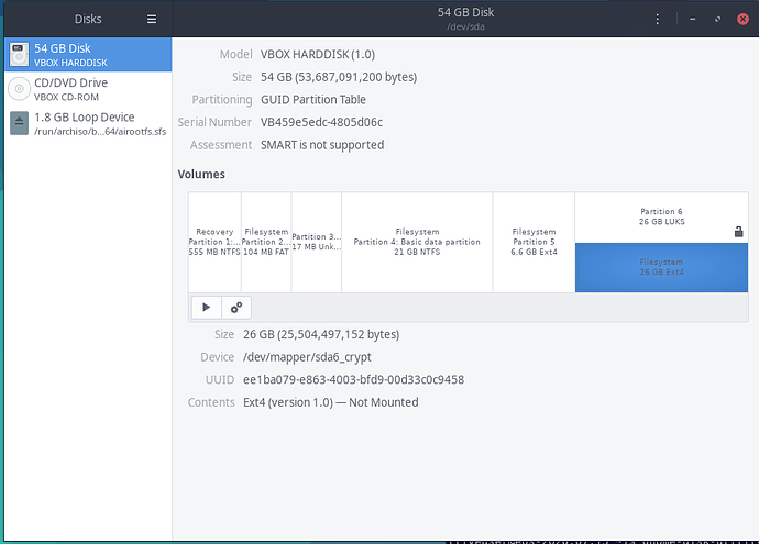

There could be bad sectors or something since I can’t seem to resize an encrypted partition, even when I did a scan for that encrypted partition

I assume you’re still frantically looking for a way to resize a luks partition with a GUI application, like gparted? :wink:
Anyway, I don’t think your drive/partition actually has any errors (bad sectors) at all.
It’s just that gparted will not resize the luks partition without knowing if the contained filesystem, in your case ext4, is “clean”.
When running sudo e2fsck -f <your opened luks device> manually, the underlying file system is forcibly checked for bad blocks and marked clean. Gparted then allows you to resize this luks partition.
I assume that gparted doesn’t do this needed “forced” check; you’ll just have to live with the manual intervention for now :sob: … :grin: .

Ok so it is happening again. I tried to repair it via sudo e2fsck -f <partition> and it thinks everything was fine, even though I could not resize it.
The option to resize it was greyed out :frowning: I tried repairing the partition via this program but it did nothing.
Had the same issue just like gparted.
The only way I fixed it was I mounted it to /mnt sudo mount /dev/mapper/<luks encryption name> and then unmounted it sudo umount /dev/mapper/<luks encryption name> and then I used gparted to resize it and it works.
How does this make anysense, how come i have to mount and then unmount it and it now all of a sudden works? This really confuses me?
