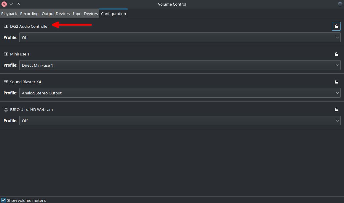

How do I disable this audio device?
I want to disable this ‘DG2 audio controller’ but not sure what is the best way to achieve this. I checked my BIOS and found an onboard audio device, but that just got rid of the ‘built in audio’ controller. This DG2 is an intel audio device according to terminal output, but I’m not sure how to disable it.
Looking to do this on both EndeavourOS and my Debian machine.

Device 1 is the one I already disabled in my BIOS that appeared as ‘built in audio device’ in pavucontrol. Not sure why it doesn’t also disable Device 2.
Disabling the driver for Device 2 wouldn’t be an issue as far as I can tell. How can I do that?
It’s annoying because it automatically turns on at least once a day, so I’d like to put an end to that. It’s never going to be used anyway.

DG2 should be referring to an Intel Arc device, so I’d assume that it’s the HDMI output if you have an Arc GPU?
Yes I have an Intel ARC GPU but I don’t use audio from the GPU.
This solution did the trick. Thank you sir.
