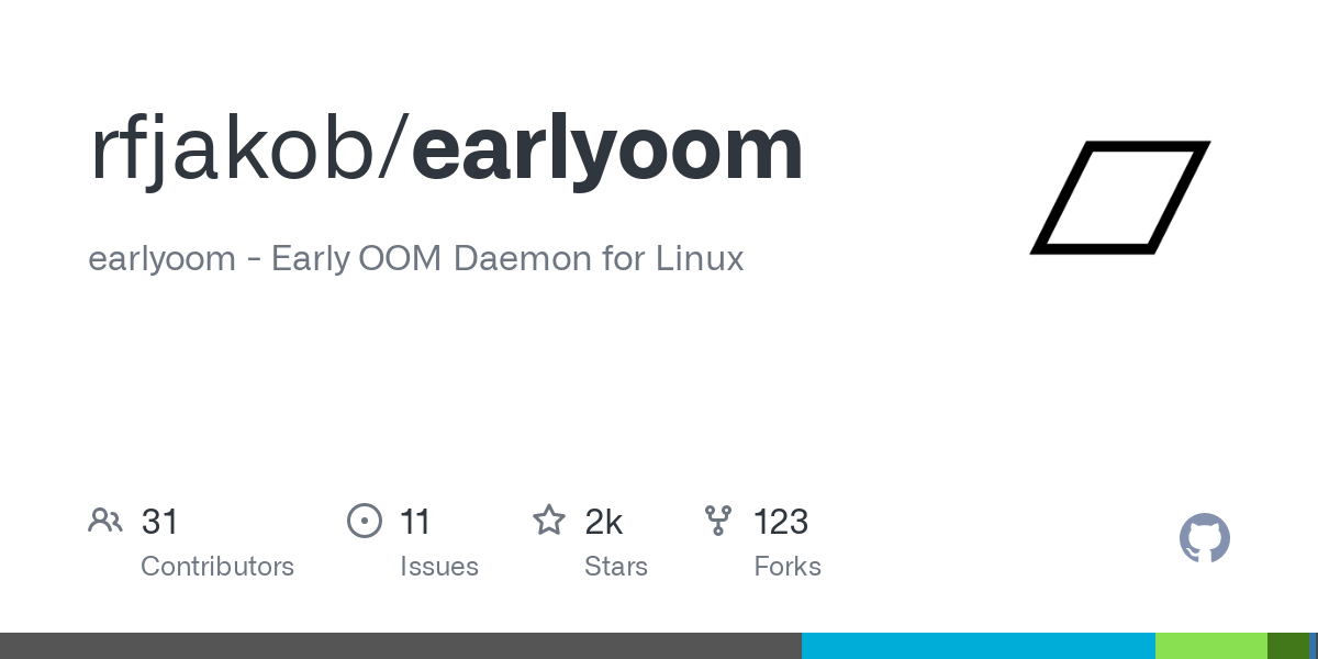

Found this:
You can install and enable it:
  sudo pacman -S earlyoom
  sudo systemctl enable --now earlyoom
Note that I haven’t used this so I don’t know anything more about it.
