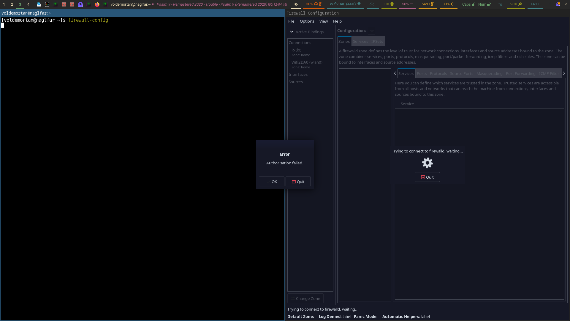

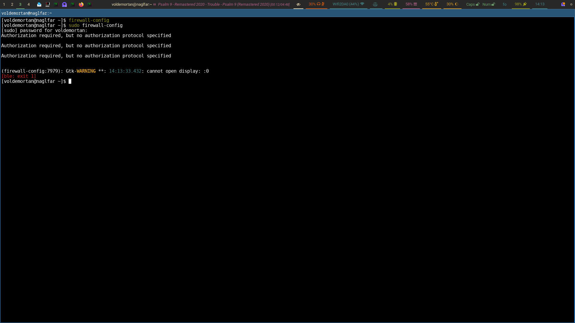

My problem is that when I am on Sway, I’m not allowed to enter “firewall-config” even with “sudo”.
On Plasma I get a prompt asking for my password, when I enter firewall-config.
I have also encountered this problem on Sway, while trying to start mailnag for the first time, and also a couple of other times.
I also have to type in the wifi password every time I log in, which I don’t on Plasma.

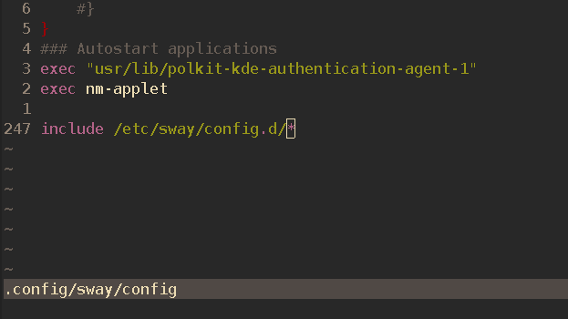

You need a polkit agent installed and started. See for example my blog post:
Hi it’s funny you should mention it, as I started following your guide when I installed waybar.
I had hoped I had skipped that step, but sadly I had not. that line is in my config:
But perhaps I have set it at the wrong place in the config?
Thank you very much for your guide by the way, it was of much help, even though I sort of got into it backwards, as I started with the last part of the guide, and then began at the beginning.
exec "usr… should be exec "/usr…
Seriously! It was that stupid! The answer was staring me right in the face! :person_facepalming:
Thank you so much!
