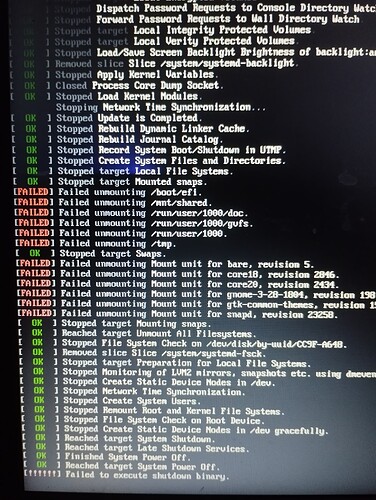

Hey guys, I was just editing a file in the terminal (vim) and then suddenly the cursor didn’t move, I thought something’s just weird with vim today and just closed the terminal. That’s when everything went into freeze mode and nothing was responding. After about 5 minutes system went into shutdown mode on its own…BUT it didn’t even shut down properly. This has NEVER happened before.
And now this is all I see. I’m just letting the battery drain for now. How do I recover from this? Will this destroy my system?
I would think that holding the power button is better than letting a full power failure occur.
From there .. you are probably gonna wanna at least run fsck from a live environment (ISO/USB) on those partitions.
The original anecdote sounds somewhat absurd .. but may be some combination of a runaway process and a watchdog (which can try to shutdown the system under certain circumstances).
