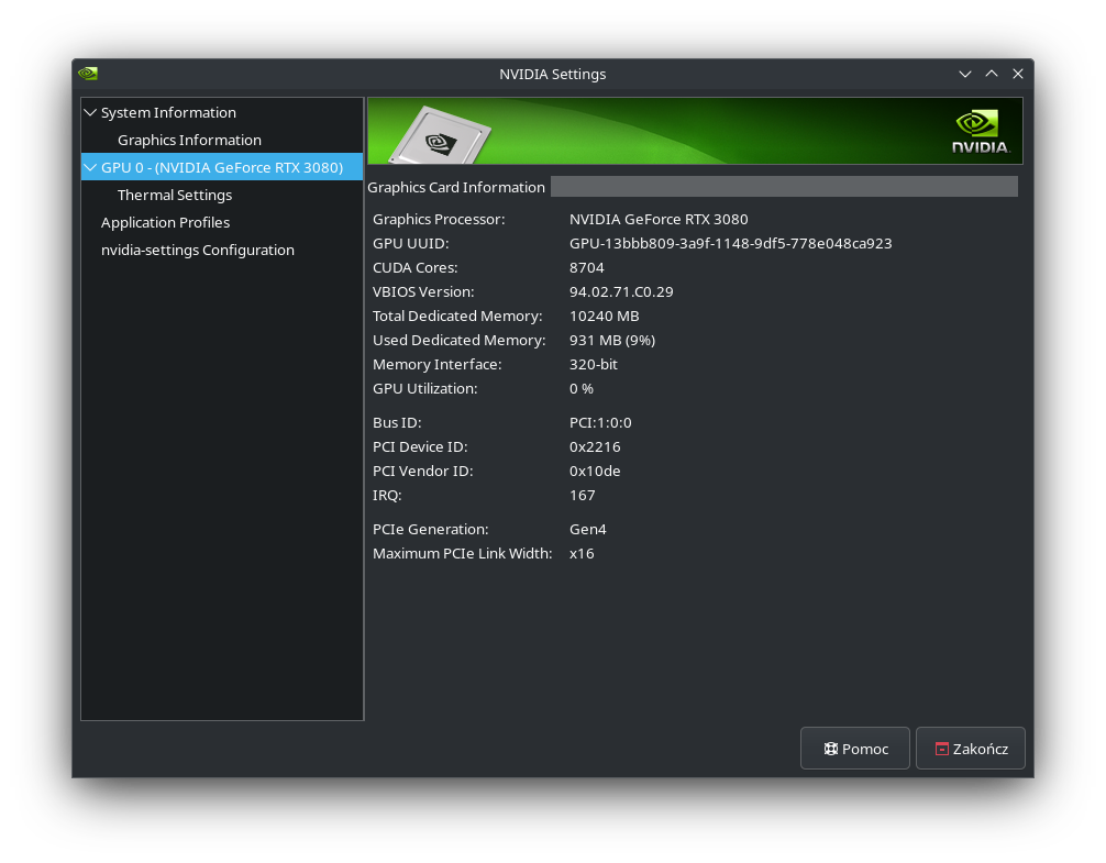

One possible clue I discovered, was that my nvidia-settings doesn’t really show any information. Although I’m not too sure what to make of it.
Any help will be much appreciated.
nvidia-settings only works properly under X11. Under Wayland it only shows what you are seeing on your screenshot. This not a bug / problem.
