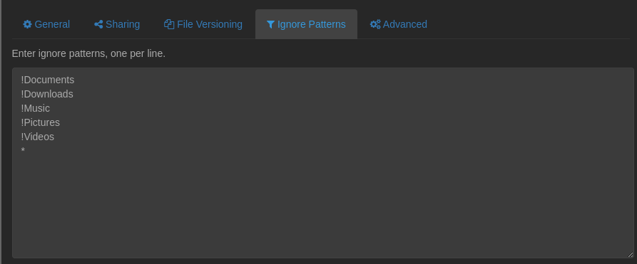

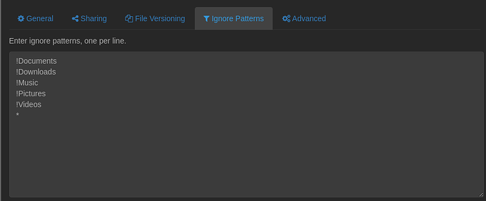

Don’t let @dbarronoss discourage you from exploring this. Setting up Syncthing isn’t rocket science, and its ignore patterns feature lets you easily exclude all other home folder contents, syncing only the folders you specified.
Sounds like you don’t have too much experience with syncthing.
This entry in the ignored patterns tab solves the concern you’re voicing. All other folders are ignored, and specifically the folders that OP voiced that he wants to keep separate are backed up to a remote device.
It doesn’t take an intermediate skill level to pull this off. Just saying.
