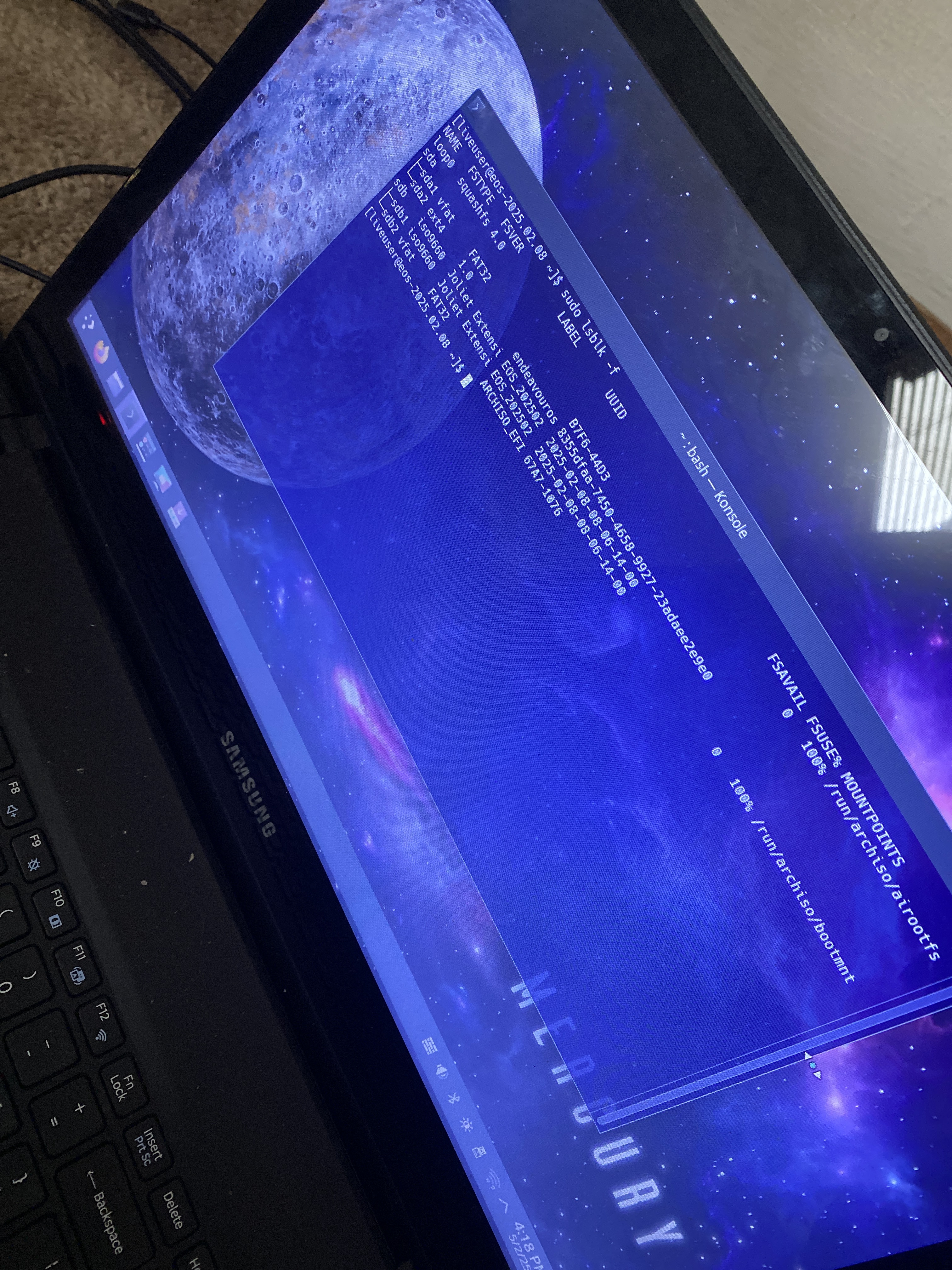

After running the command yay and restarting my pc I am greeted with so…
I log into my usb installer for EndeavorOS and sudo lsblk -f
This is what my partition looks like…
Any help would be appreciated

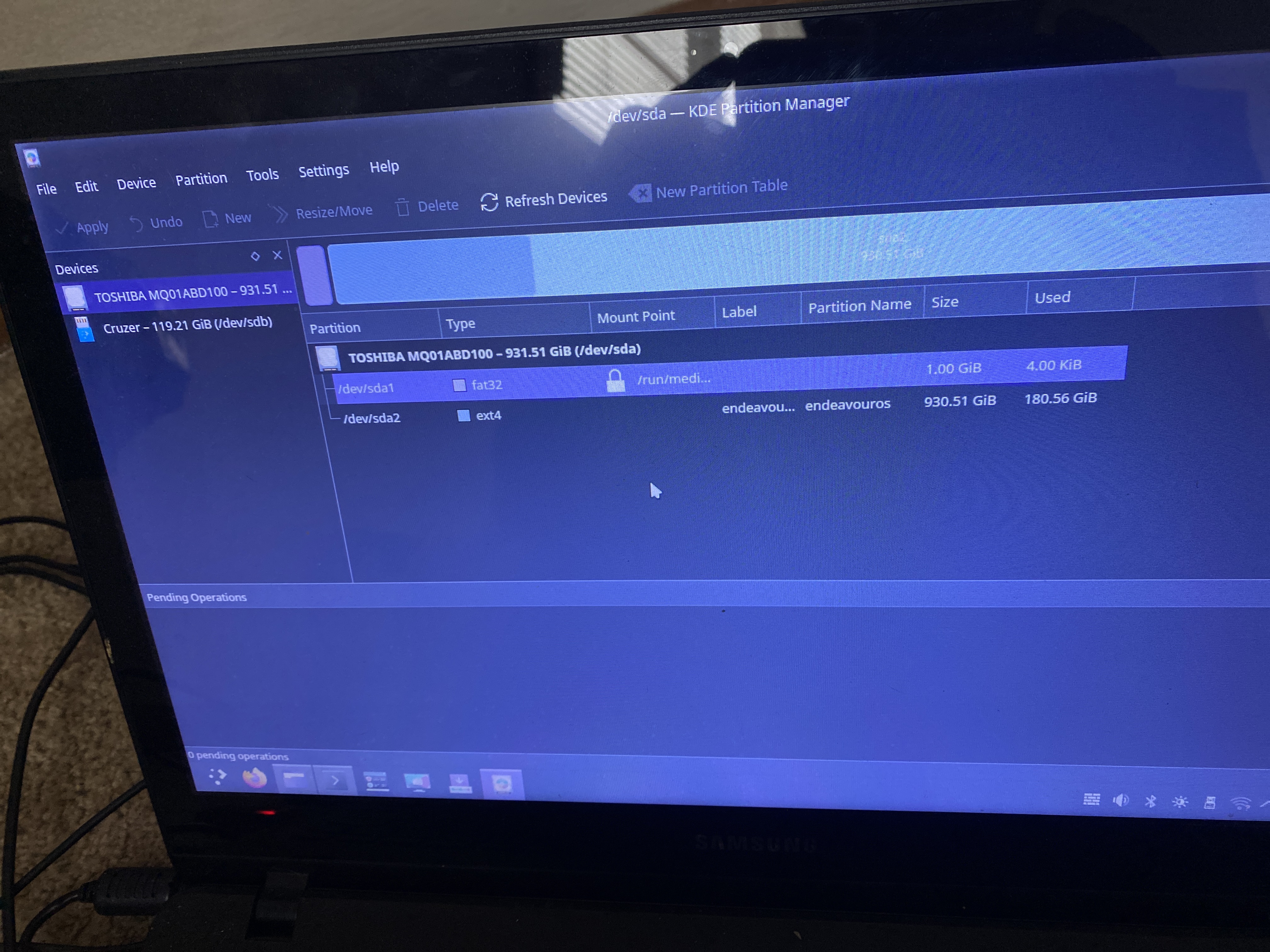

Boot from ISO, arch-chroot, and reinstall kernels (note I’m not sure that’s the problem but that’s common and relatively easy to try).
Actually would be helpful to know what you did with yay if that’s the only upgrade since it last booted successfully.
I booted to ISO
Arch chrooted
Tried reinstalling kernels didnt work
Did grub-install but it couldn’t locate efi
I just went ahead with re-installing endeavoros. I didn’t want to do it that way, but it wasn’t like I had much on it anyways. I just erased it through the installer.
I feel like I gave up too soon, eh, oh well for now
Did you use this wiki ?
https://discovery.endeavouros.com/system-rescue/arch-chroot/2022/12/
I did as well as the grub & reinstalling kernels. I got stuck on trying to figure out where the efi was so then I just went ahead with the installer
I think it was only a boot priority misconfiguration in your BIOS/UEFI
