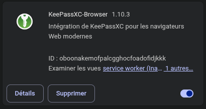

Has anyone being able to use KeepassXC with Helium browser ? I am able to install the KeePassXC-Browser 1.10.3 extension into Helium :

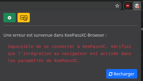

It seems Helium KeepassXC extension is unable to connect to KeepassXC :
Therefore “no database found” message found in extension parameters…
Thank you.
You need to enable the “Google Chrome” one instead of “Chromium” in the KeePassXC Settings.
