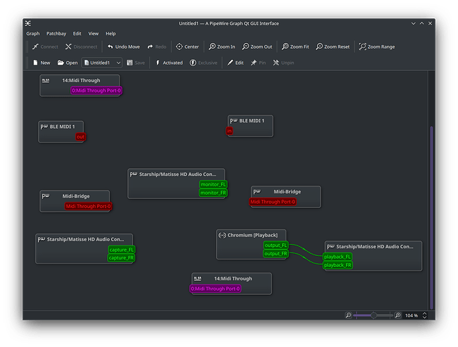

So we can visually see what might be happening, could you install qpwgraph. It’s a graphical tool that’ll let you see how your audio input/output is connected.
Here’s mine, for example:

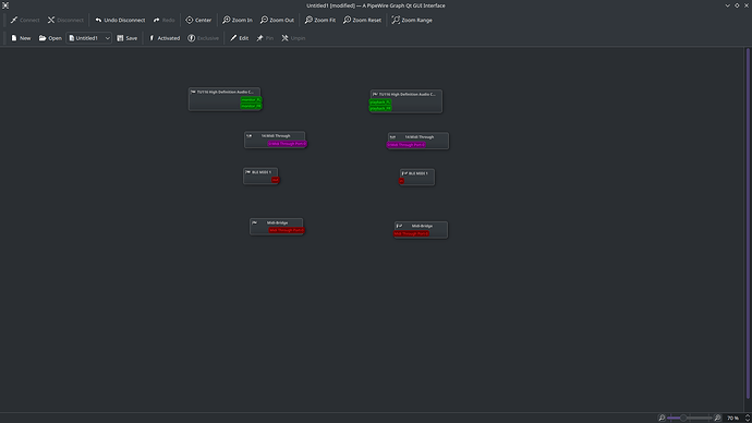

This is all that I see, none of them seem to be connected.
That’s fine, it’s probably just that nothing is currently playing. If you could replicate the what you’re doing when the issue arises, that would probably have a clearer picture. Let’s put that aside for now though, I have another thought.

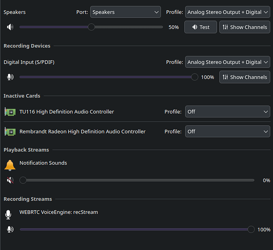

Could you share a screen shot of KDE’s audio settings:
System Settings > Sound
And describe what you’re using to hear and speak. Eg, headphones with a built in mic. How are these connected? USB? Separate jacks for output / input, or a single jack for both? Where is this connected on your PC?
What I suspect, is it’s a duplex setting.
Here are my sound settings
Mb, I forgot to include what I use to hear and speak. I use headphones with a detachable mic. I do have to use a headphone splitter if that means anything.
Under Speakers there, try setting the profile to “Analog Stereo Output” only.
With the Digital Input (S/PDIF), that should not have “Analog Stereo Output” included in its profile. Can you click that drop-down there and screenshot the other options?
Is any part of your audio connected via USB? Just trying to figure out why it’s set to “Digital Input”. How is your mic connected, specifically?

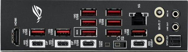

Oh I misunderstood, my bad. As I mentioned, I have to use a headphone splitter, and i just plug the jacks for both mic and audio directly into the motherboard on the back of my PC. I can send a photo if it helps.
If that’s not too much trouble, that would be clarifying :slightly_smiling_face:
Oh it’s just two ports on that motherboard. Mic-in and Line Out. Is this the one?
