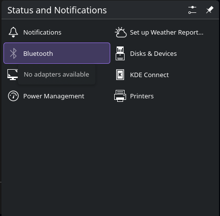

And now after a regular reboot it seems as though my bluetooth doesn’t work either. Just what is going on with my system?
Have you already read and tried this? https://discovery.endeavouros.com/category/bluetooth/
Alright so as it turns out a cold reboot seemed to have fixed the issue. Honestly surprised it was that easy, but thank you to whoever decided to take the time to look at this.
