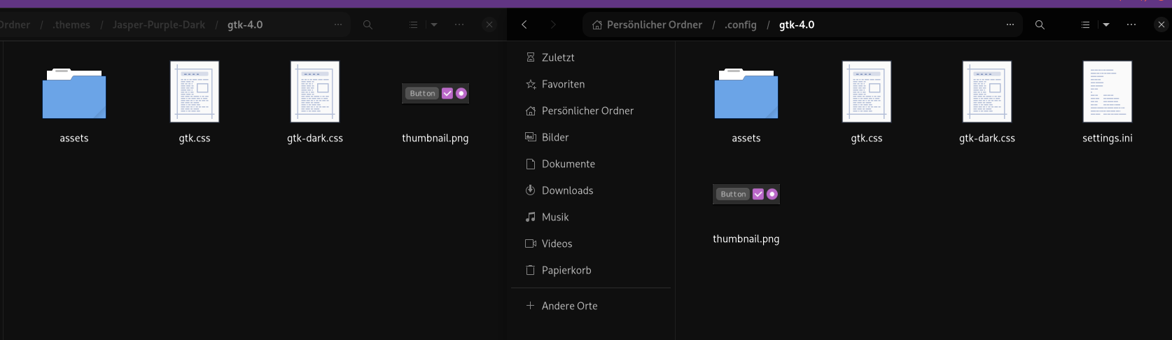

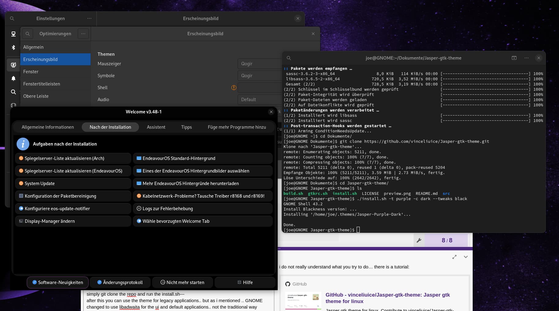

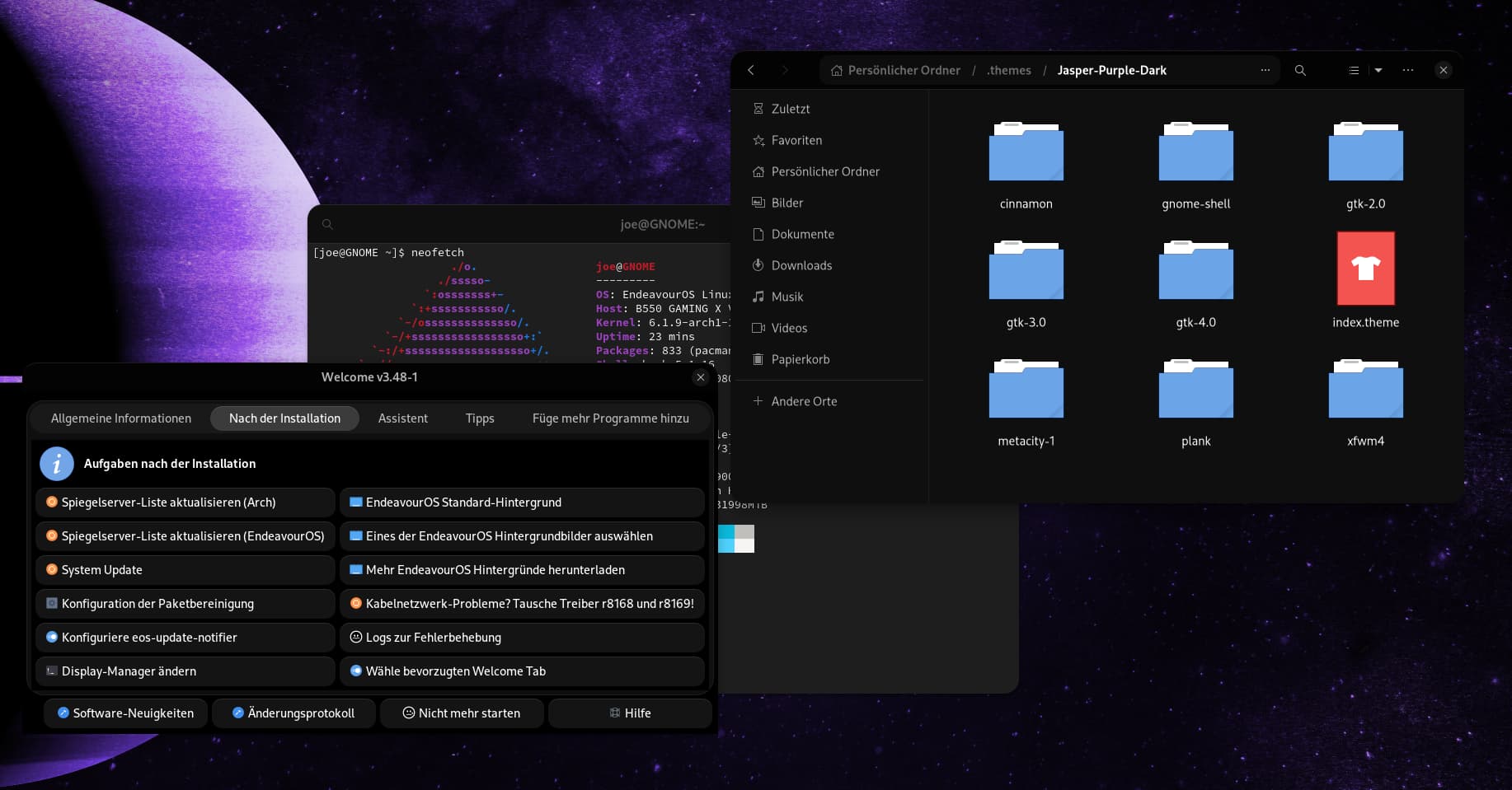

i do not really understand what you try to do… there is a tutorial:
simply git clone the repo and run the install.sh—
after this you can use the theme for legacy applications… but as i mentioned … GNOME changed to use libadwaita for the ui and default applications… not the traditional way anymore.
to hack GNOME to use this theme all over you need to do this:
git clone https://github.com/vinceliuice/Jasper-gtk-theme.git
cd Jasper-gtk-theme
./install.sh
cp -R ~/.themes/Jasper-Purple-Dark/gtk-4.0 ~/.config/log out and back in … and it will work…
