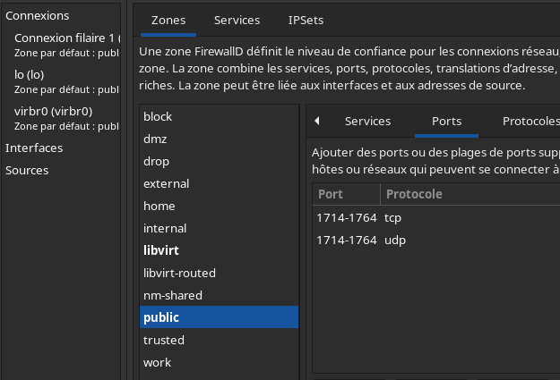

Reading that thread long time after, but in case it can help someone :
I faced the same issue, and I solved the problem by adding the following ports to firewall :
Thank you so much. It did work perfectly following your suggested solution.
