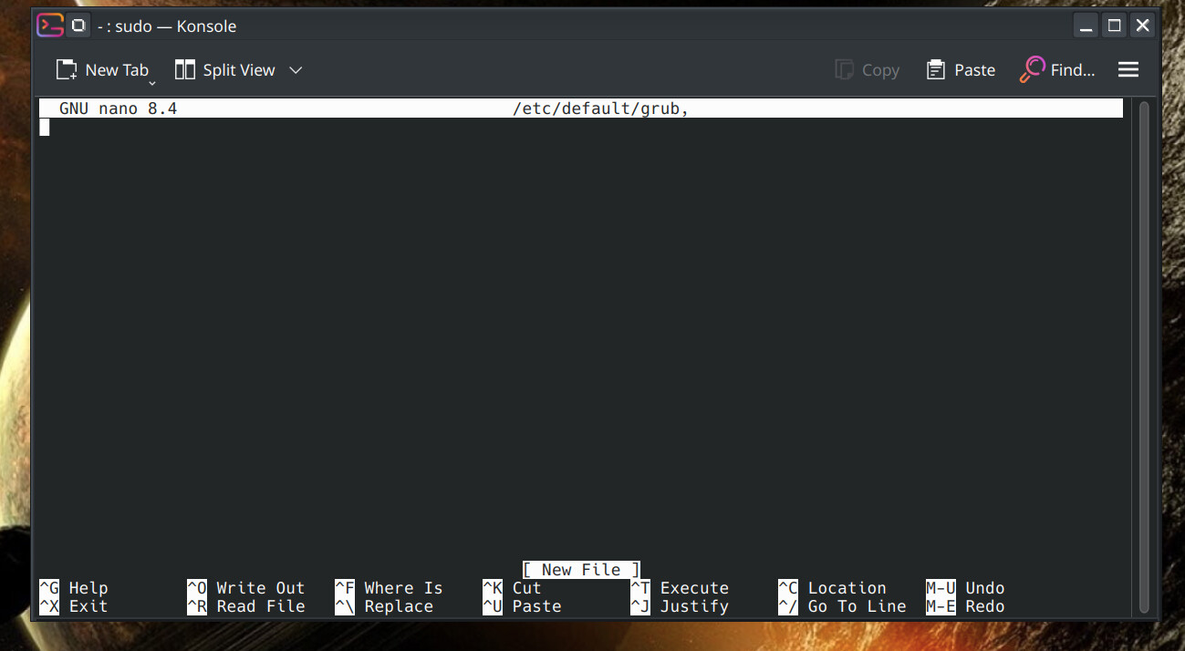

Hi, i tried to remove boot diley from 5 to 0 but i dont know how to edit.
When i put this : sudo nano /etc/default/grub
the terminal open this menu and i dont know what to do next

Running the grub-mkconfig will overwrite whatever changes were made. If you don’t have an /etc/default/grub, then maybe you’re running systemd-boot.
What does sudo bootctl list return?
Directory ‘/boot/grub’ does not exist ]

Sorry for the confusion on my previous post , anyway it looks like that you don’t have Grub as a bootloader check for a file loader.conf if you have systemd boot you should have that file.
