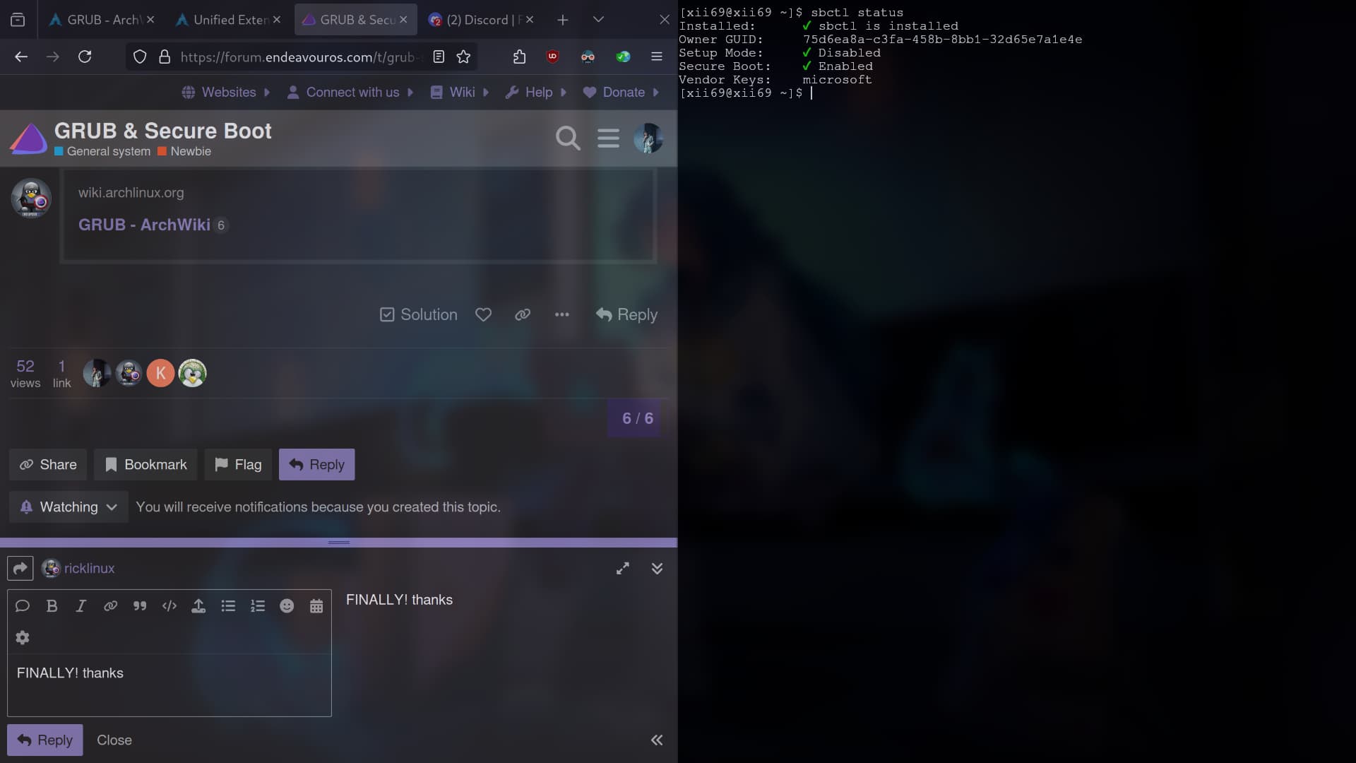

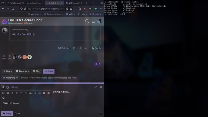

FINALLY! thanks
My problem was:
1- I didn’t install grub correctly to support secure boot, correct installation command:
grub-install --target=x86_64-efi --efi-directory=/boot --bootloader-id=GRUB --modules="tpm" --disable-shim-lock
2- I didn’t disabled “idk what validation” with mokutil --disable-validation
